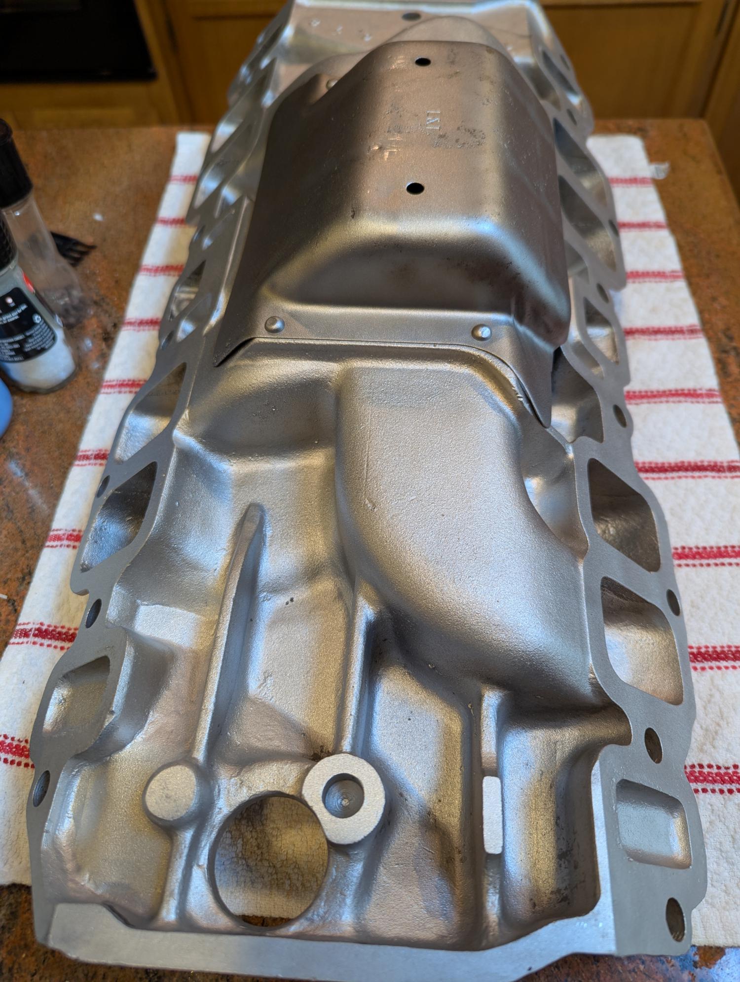

Regarding the above 3963569 Intake.......Was there a different version after 1970....I've heard of a style with the Cyl # cast onto each port runner (1,3,5,7 etc)
Any other points, issues to inspect for
Best way to release steel water hose fittings
Is Steel (Fine) Shot Blasting The Best Way to restore OE Appearance
$$$$ Going Value in 2018 ????
Thank You
Chuck Sharin

I dont follow EBAY Sales................
Anyone have thoughts on 2022 pricing/value on 569 Intakes..........
Still asking about steel shot blasting for cosmetic restoration
as glass beading doesnt leave an accurate "look"

Vapor blasting is the best aluminum cleaning I’ve seen. Steel shot would work the surface way too much IMO

I ve read about the MIRACLE of Vapor Blasting but havent experienced it myself.....
I'm "thinking" that sand cast parts were run thru shot blasters (Wheel-A-Brator) when they were 1st mfg.........and I believe that short (under 5 minutes) periods in a shot blaster would make a sand cast manifold look like NEW again.........We shall see !!!!!!

What is vapor blasting?

https://www.raptorblaster.com/what-i...-wet-blasting/
