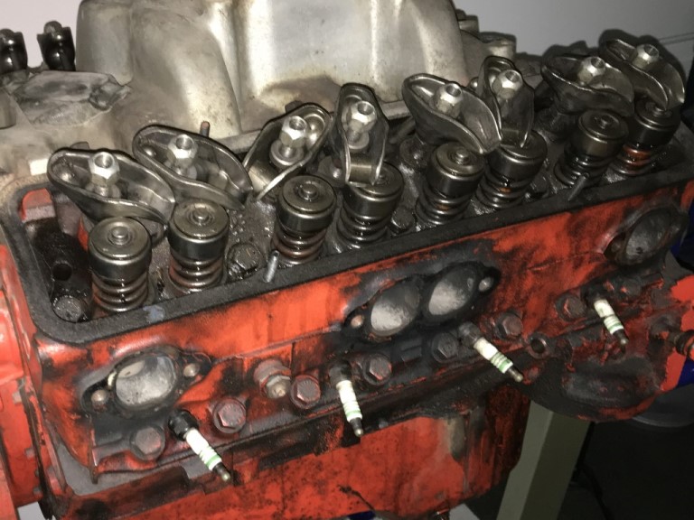

Default What cam would you run in a day 2 69 Z28
Title says it all
Stock 302,
Headers,
Wide ratio and 3.73
Do not wanna loose the Z28 character
I have the 140 in the car now - its too much for a driver

So - Howards Cams has a Lt1 lobe which they spec at 316 adv, 242 @.050 and 144 at .200
.459 lift
I was thinking of having them grind me a smallblock version od the L78/l72 cam
316/316 - 242/242 on a 112
Or go with a 112LSA Lt1 cam 316/336 - 242/254
Or do you think messing with or trying to redesign GM cams is a bad idea?

I like the 140 cams but your never going to get much grunt out of that 302 from light to light. Either throw a set of gears into it like Sam suggested, or maybe go back to a 30/30 grind. The newer 12-673-4 nostalgia cam has the best of both worlds in a solid lifter. Sounds old school and has better bottom end performance out of the hole.
The car I just bought has the Comp 12-107-3 Muscle Car Cam which is a direct replacement for the 3849346 cam and it works really well in the 302. What else are you doing for the Day 2 finish?

No need to be to technical. Put the 140 cam in with a set of gears or even the stock cam will do. Small blocks with high rev cams need gears or your defeating your purpose. Have the carb done and the distributor done along with a good exhaust and you will run great. Hopefully you have the forged pistons in that motor too, or your "old school" sound will not be there. Its all about the combo. Good luck!
Ask (67 Nova Boy Dave) what Comp Cams he is using in his 302. That car sounds great!
