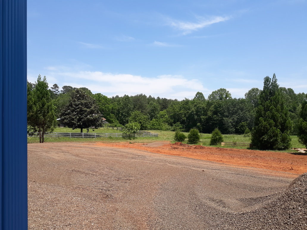

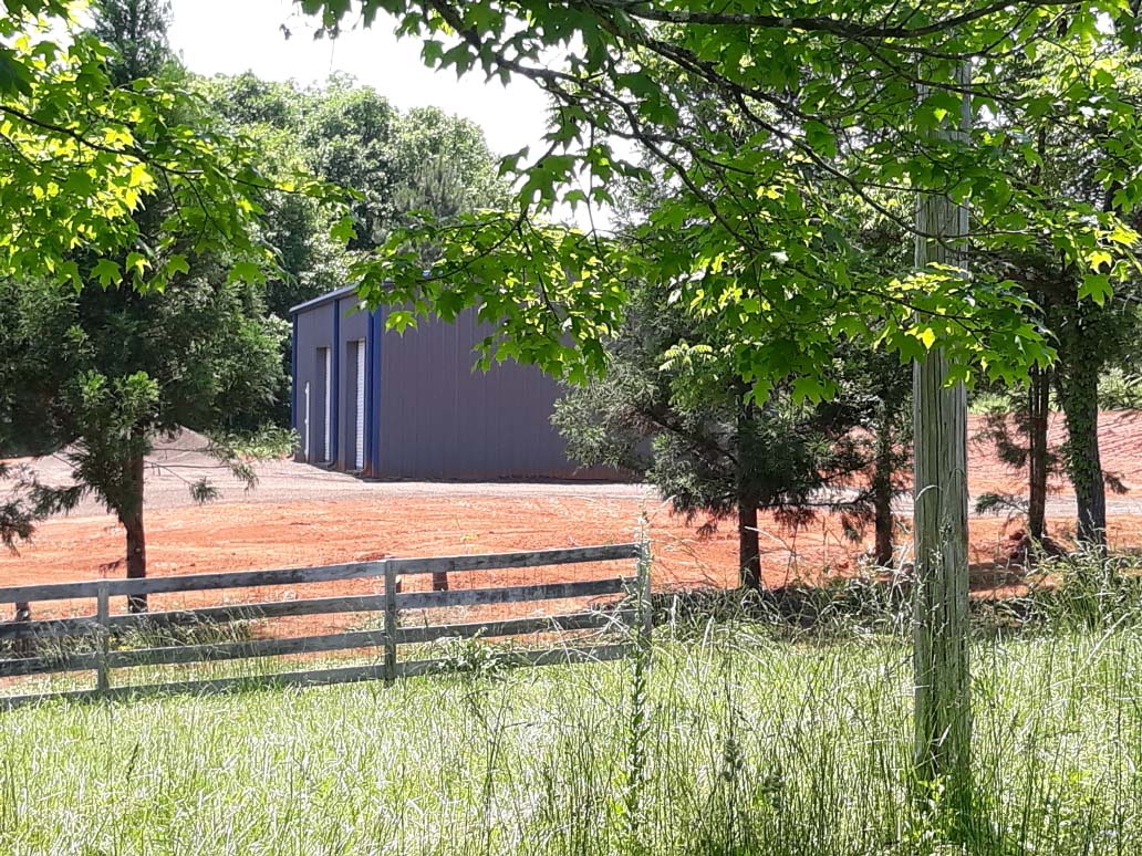

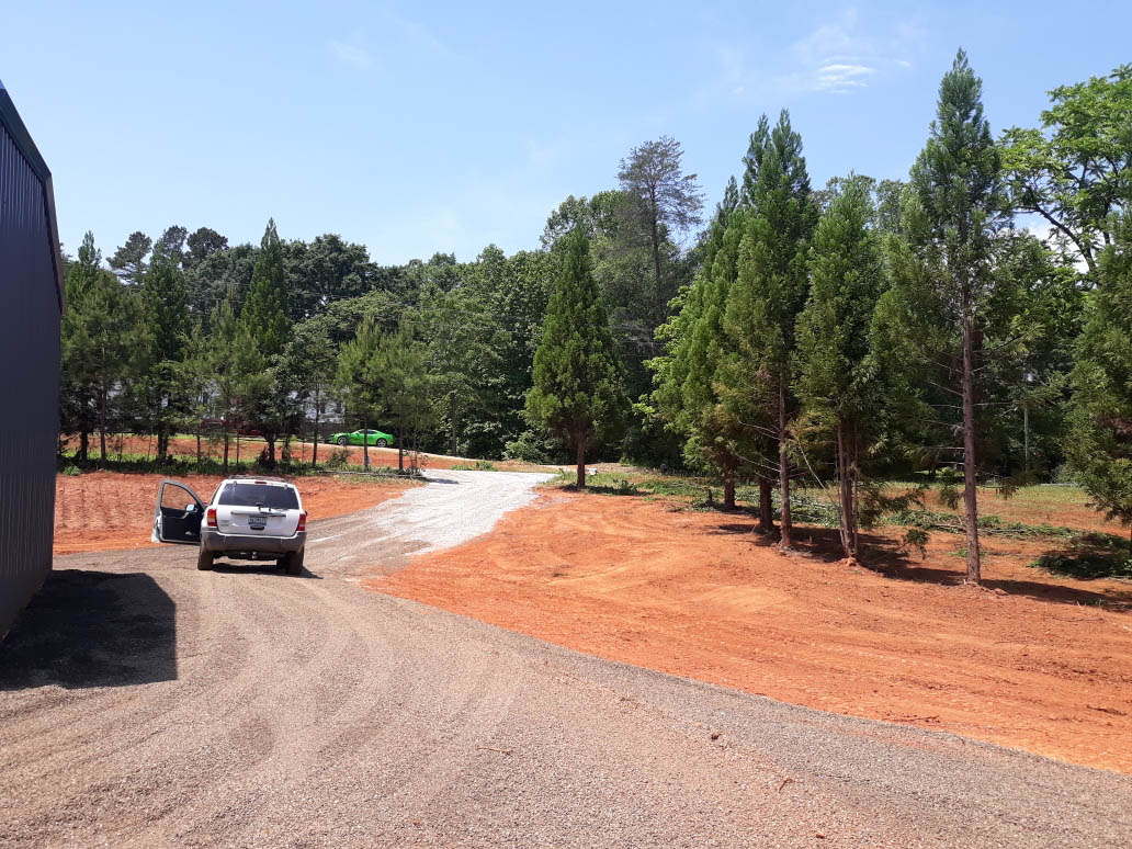

Finally found a piece of property and have a contract, (closing later this month) on a nice piece of property after looking for-EVER...
7 Acres - 25 minute drive from the intl airport- 12 year old SOLID Barn... Creek... spring... 250 foot well... granite outcroppings... 10 miles from I85 little north of the midpoint between Atlanta and Charlotte.
Now comes a building... and spray booth.
