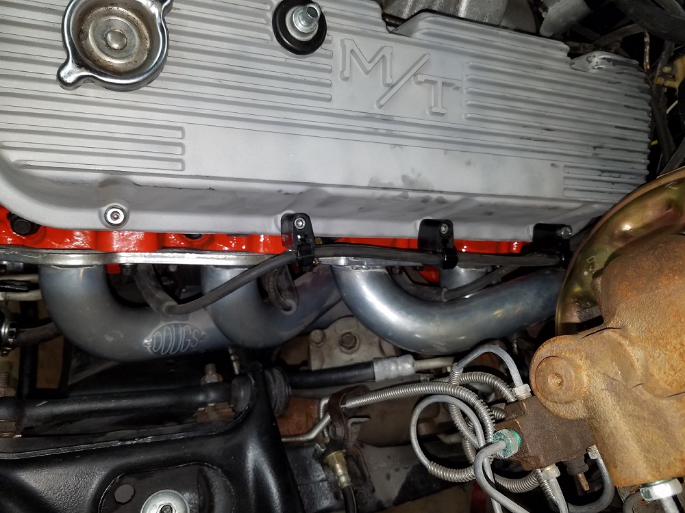

Putting together a day 2 1st gen big block Camaro . Does anyone know of any modern headers that will work with factory a/c and power steering? Thx Tom

Not sure about factory a/c, but Dougs fit my 69 BB pretty well. Not excited about the oil filter access though. I would also probably get them uncoated and send them out next time. I don't drive in the rain and I have some rust after two years down by the o/f.

Do you have a part number on the headers? how do those valve covers fit near the booster area? Thx
D320. I'll do you one better, here's the link: https://www.summitracing.com/parts/dou-d320
My M/T covers fit perfectly near the booster. Not even close. The only issues they have is when you go to a/m rockers etc. I bought a second set that I didn't mind grinding down the drippers on.

Ckd the Dougs website and says thay will work on an a/c car so thats good. Whats the situation with the oil filter access? Hows the starter access?
