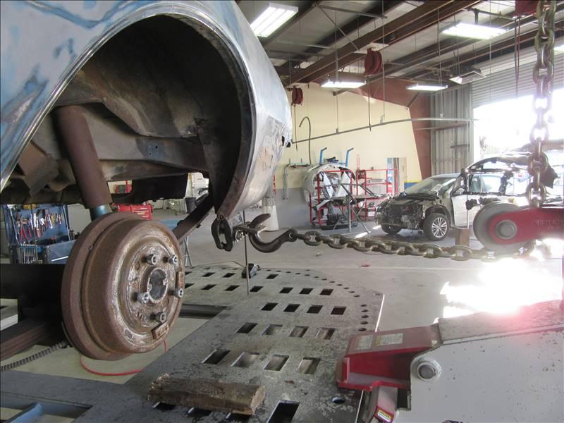

I work part time at a major collision repair company, although I don't do that work. I have my own back room where I do restoration and modification work for them. There is a frame rack back there and I brought the Chevelle there a few weeks ago. After stripping the front sheet metal off, the shop owner and I straightened the left frame horn that took the brunt of the impact.
I then locked the frame down and put 6 gauges on it to determine where and how much the frame was bent. I pulled the front rails left 5/8" to get them, and the front crossmember, back in alignment.
Once we had the frame looking good, I installed all the used sheet metal I have acquired for a trial fit. It is very close and is well withing acceptable gaps to turn the car around and pull the rear damage out.
The rear damage is causing a twist thru the center area of the frame.
I need to get the body pulled back into shape before we can do all the final frame straightening and check for a diamond, which we assume it will have too. That is the next task. I will turn the car around next week and start on the back.
I did pick up the 1 piece trunk floor, left quarter panel, tail panel and all the wheel houses yesterday, so I have most of what I will need to rebuild the body, once it is pulled out and all the inner structures are back in place.

Here we go, rip, tear and dissect. I welded a pulling tab on the bumper and pulled that out far enough to gain access to the mounting bolts and remove it. The quarter started unfolding with it.
Once the bumper was off, I went to remove the wiring, but it was routed thru small holes in the frame and I had to cut it all apart to get it out. The connectors weren't going to fit back thru those holes.
Once that was cleared, I used 2 clamps on the quarter and tail panel, pulling them far enough to relieve the pressure on the frame and pull some of the deep buckles out.
I had the body locked to the rack in front of the left tire and 2 ratchets holding the front of the frame from going backward and another chain holding the front from pulling sideways to the left from the towers at the rear.
20 tons of pulling power made easy work of unfolding the quarter and getting the door pillar back where it belonged. I have a very even gap again.
This pic shows how far the quarter moved at impact. It had overlapped the door by almost a 1/2".
Then I cut out a good size piece to get access to the reinforcement inner structure at the door pillar and to relieve more of the stress of the sail panel at the roof.
There are still 2 shallow buckles but they are below the roof seam, so nothing to worry about.
