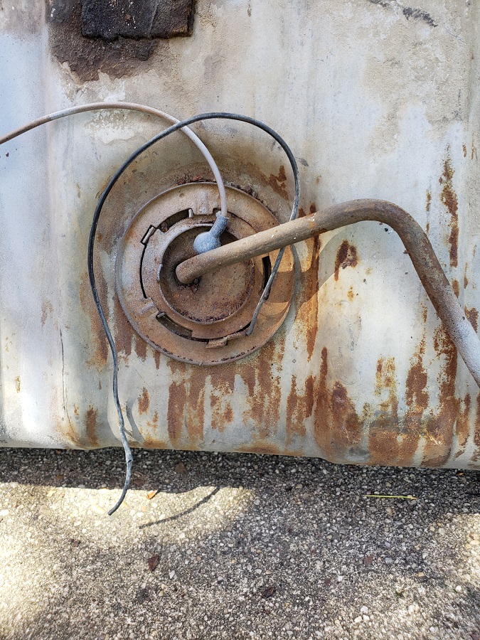

Fuel tank was out of the car but included, it is a single line pick up, no return.
There were no fuel line or brake line clamps AT all in car (since secured original single line 5/16 fuel and power brake clamps with hardware all unrestored)

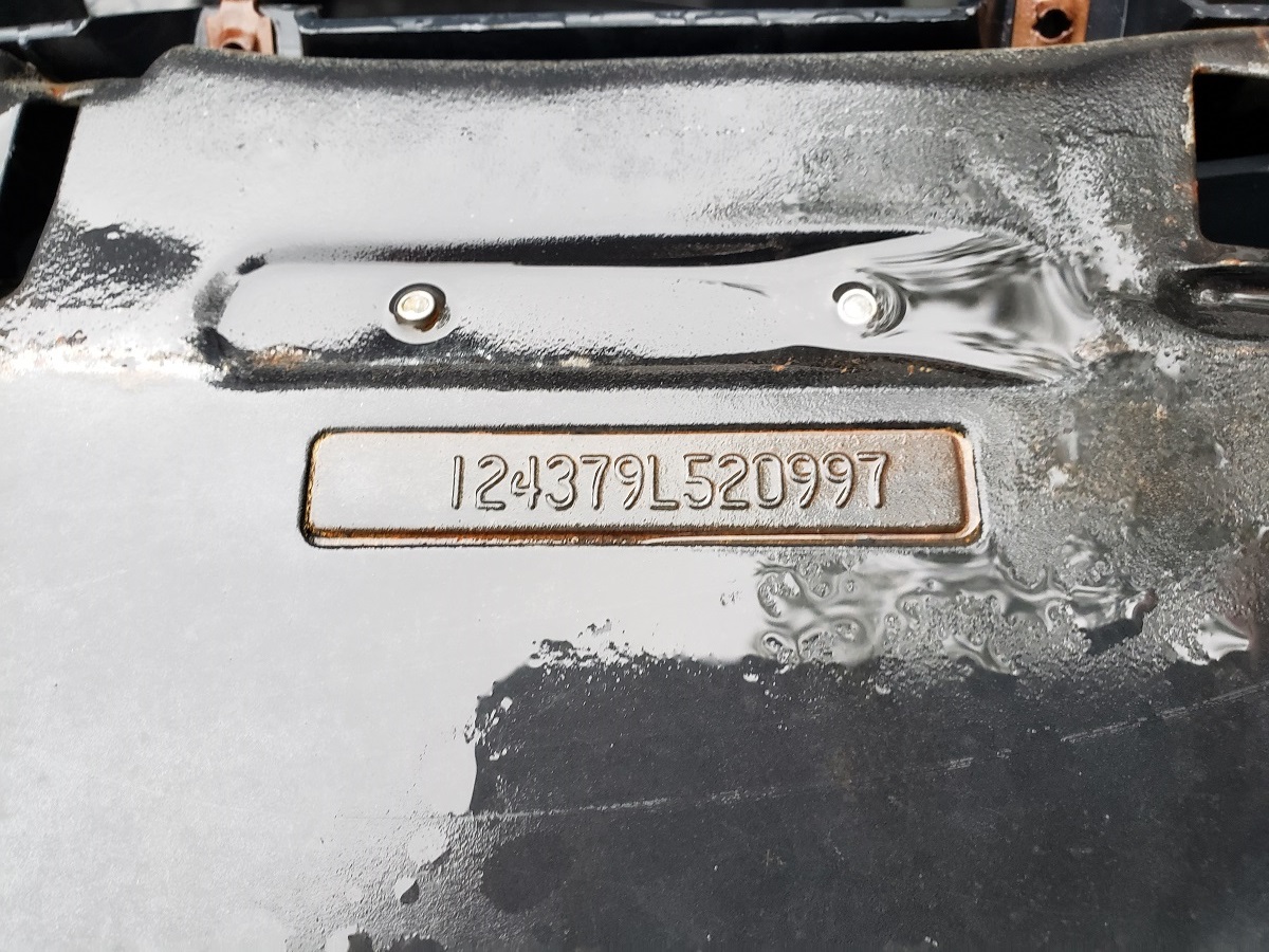

I am including the vin and data plate so there will never be any confusion on this car being what I say it may or may not be.

There are no big blocks with a single 5/16 fuel line. Are you sure its 5/16??

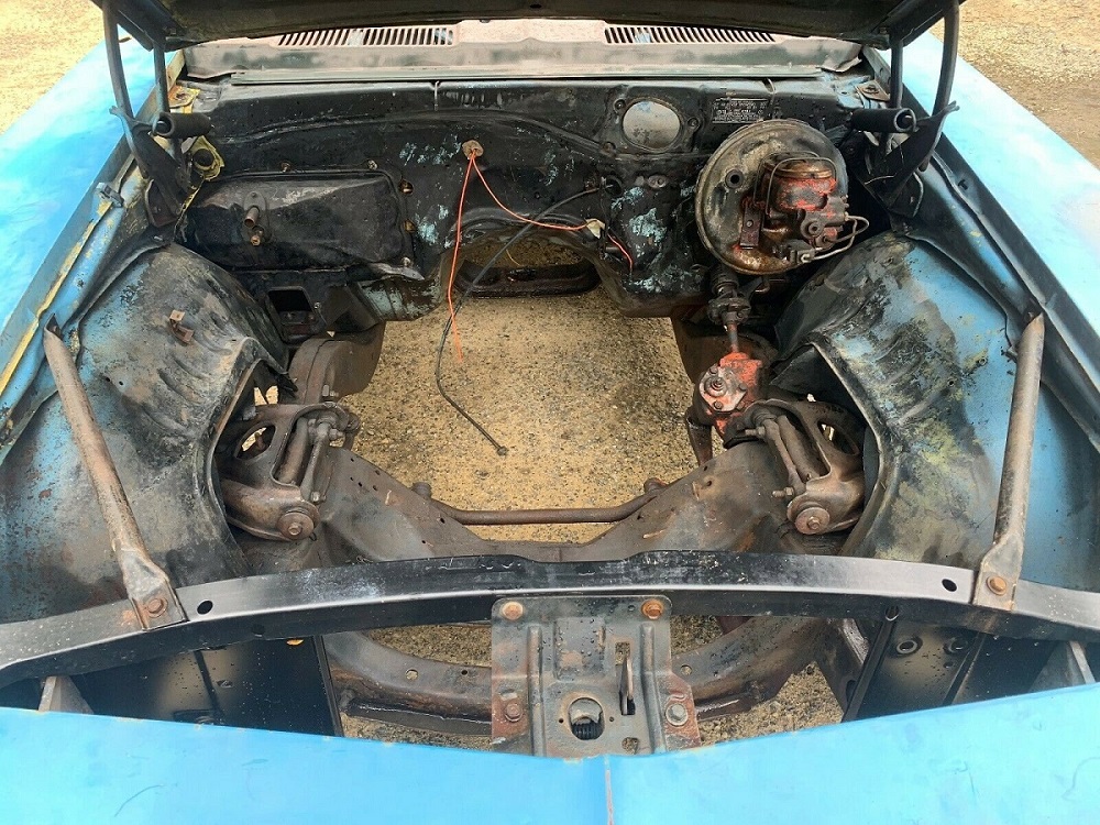

Default van nuys
is there a speedo cable and where does it come out of the firewall?

big dummy here...typo it is 3/8 fuel line.
thanks!
photo of fire wall, speedo cable on drivers side

I'll guess L-78 4-speed

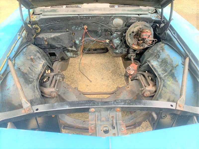

Lightened up your picture a bit

doesn't look any prettier though!

Chris...can you measure the length of the speedo cable?
