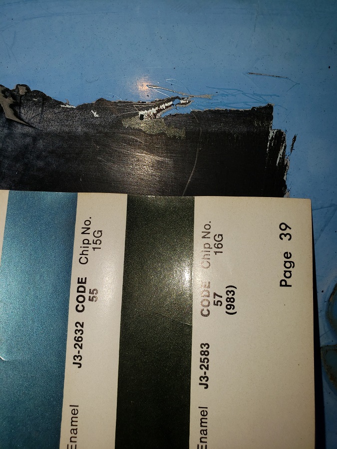

Hello folks-
I am getting some conflicting information that i want to try to clarify. NOT calling any one out at all! Some folks have been very helpful providing info info but they conflict each other.
My question is for a Fathom Green 69 Camaro SS396 is the tail light panel body color, or matte black?
one VERY trusted source within this group and others advised matte black, which i have always thought, and had read in another VERY trusted source's books.
The confusion is there is a 69 SS396 survivor belonging to a GREAT member on the site with a body color (Fathom) tail light panel.
I am still trying to establish some validity to my 69 Camaro actually being a SS396 so i scraped some of the robins egg blue (yuck) off the tail panel and the results are below in photo.
So matte black, or body color...which can i hang my hat in?
Thanks folks!
