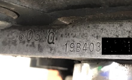

To revive an old thread, I recently was talking cars with a gentleman that said he bought a COPO engine at an estate sale. He sent me a picture of the pad stamping and it also looks to be a MN with a Q added later. Thoughts on this engine?

That Vin is in the Registry...it would be great to reunite that engine with the car.

Another MN over stamped Q

Same assembly date...
