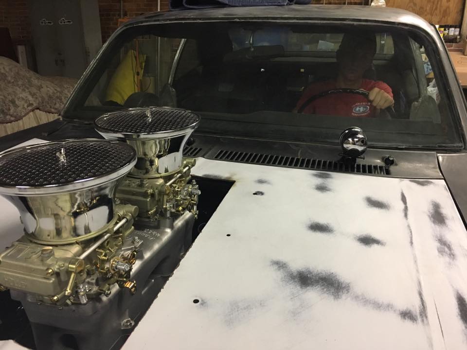

I would like to pick some member’s brains as to what they use for air cleaner filter material? I want to run velocity stacks I already have. At the top of the bell of each stack are 2 perforated screens to sandwich foam between. I could buy a furnace filter and cut to size. I don’t know if the foam is readily available? Any members have this dilemma and their advice?

Not versed in boat setups, but I don’t think boats will provide much useful info except what Scott pointed out. That being, the flammability of a filter material, which is a good point.
I do not want anything sitting on top of the stack. Must be concealed below the top of the stack. Thanks.
