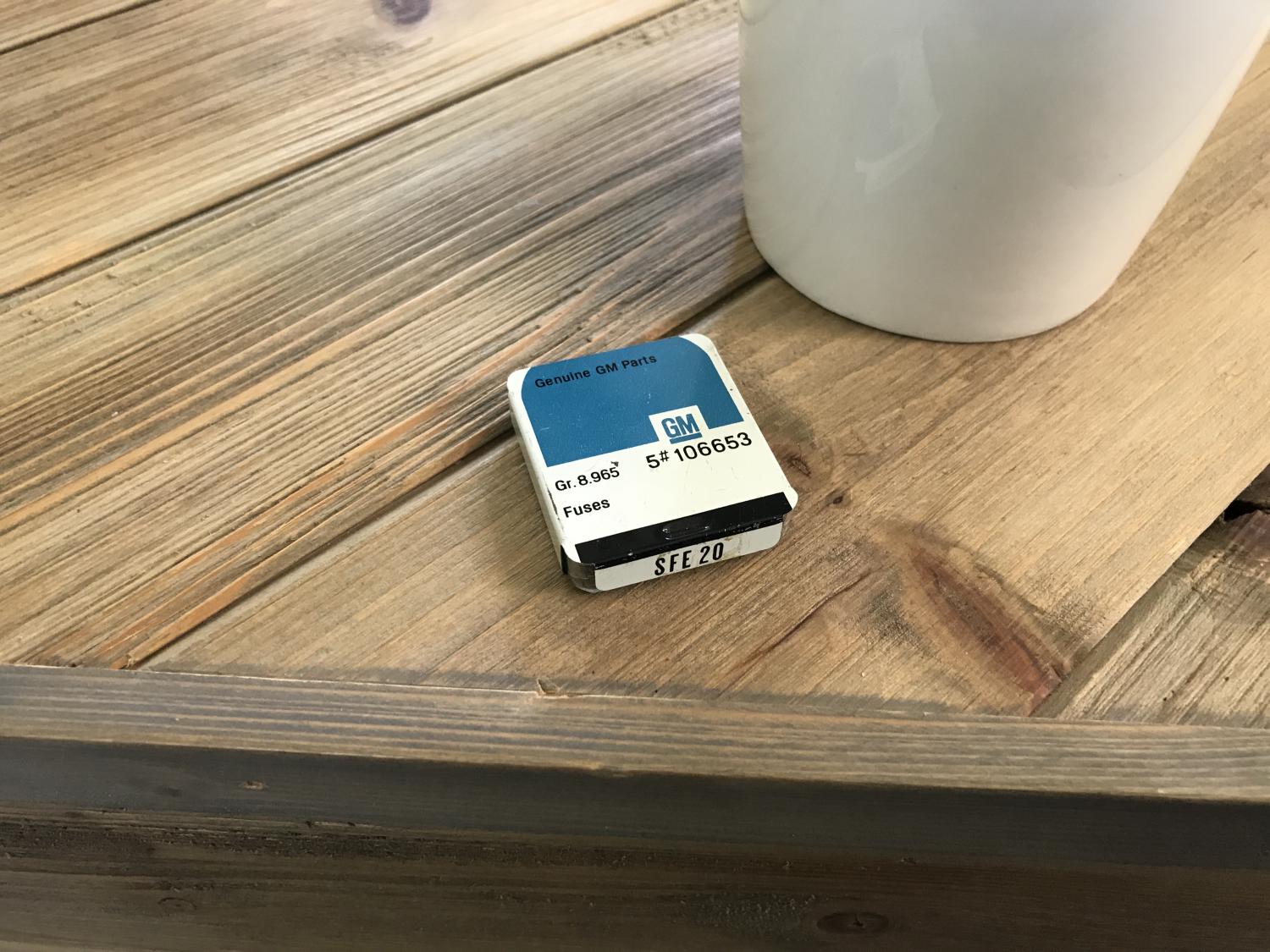

I'm going through the fuses in the fuse box on my '70 Olds. The 10 amp has the red, it looks like the 25 amp fuse has the white, and I don't have any colors on the 20 amp fuses so I'll assume those have been replaced. Where can I get the correct colored fuses?
Also, what is the correct flasher at the fuse box? I think it's the round one but I'm seeing yellow and blue ones. I think the yellow is a Tung-Sol.
Yes on 10 and 25 amp color codes. The 20 amp is clear glass and believe 30 amp blue ring. See https://www.camaros.net/threads/time...5#post-3877074

I got a box of 20’s

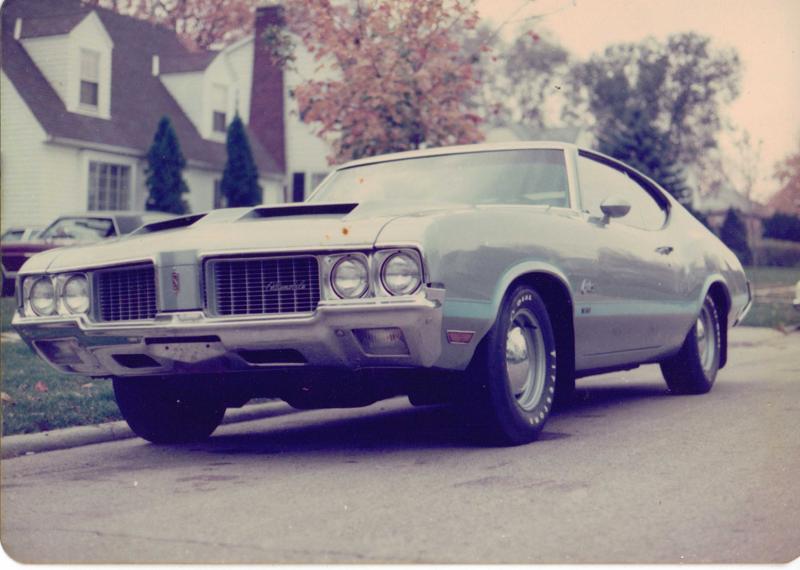

I saw your car list... and with 29 posts I figured there had to be a picture of the rarest color combo, which I have never seen on an olds...
W31 Platinum with Blue Buckets and Blue stripes...
We can't let you out of here without a couple of pictures of that BEAUTY!!!

These are vintage pictures from the '70's but they're the best to really show the true shade of the blue. I haven't seen another platinum / blue stripe W-car but I'm sure there's another one out there.

Old 11-03-2020, 01:43 AM
Join Date: Aug 2003
Location: Chicago Suburbs
Posts: 12,342
She sits perfect....as in stance
