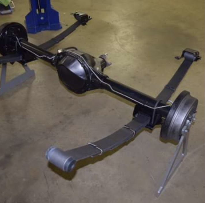

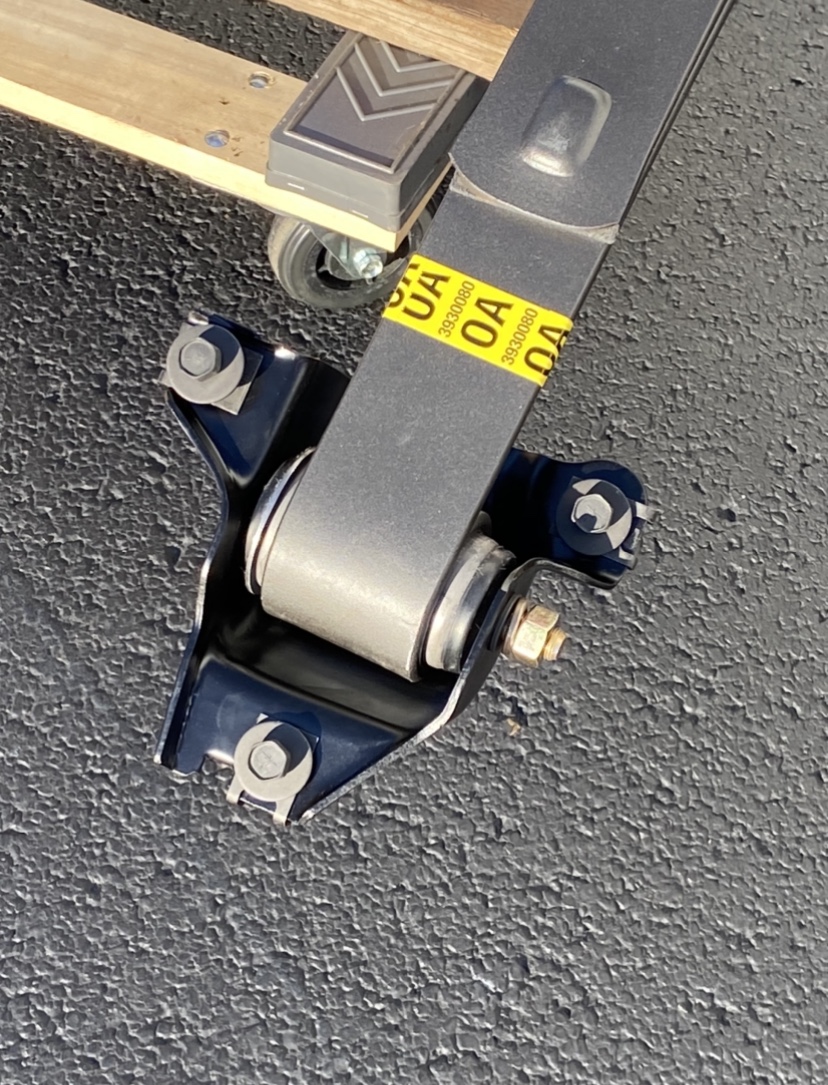

Over 3 days of researching this topic with the AIM, Here, CRG, TC and other photos and forum responses, there are so many different responses.
Bushings both pressed in from the drivers side?
Bushings direction doesn't matter?
Bushings pressed all the way in? Some guys say definitively yes.
Bushings centered? Some guys say definitively yes.
I looked at all the original car photos and there isn't much focus on this issue.
The restorations, both amateur and professional are also all over the place on this issue.
How about some photos of known correct orientation? Really appreciate it gents.

After seeing a few unrestored cars, they were pressed in from the driver’s side, so that’s what I ended up doing. Thanks guys for the input. 👍

Benny's car would be a good one to check.

Wow, everything is so clean and new.
Did you put the front mount clips and bolts on just to keep track of them ?
