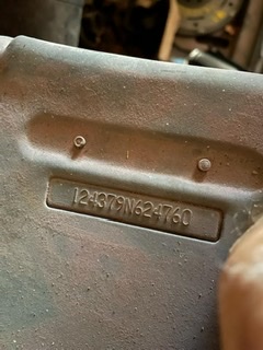

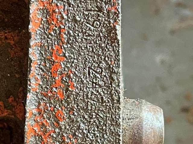

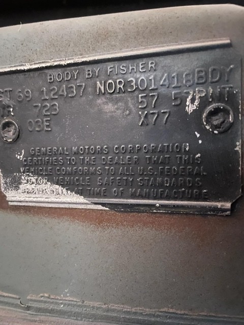

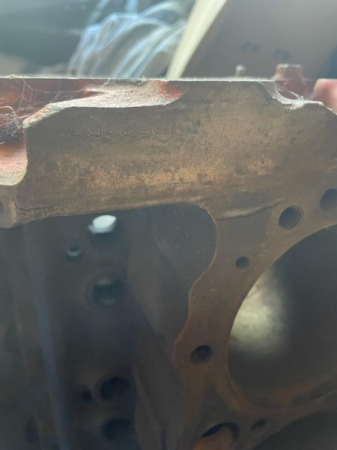

Hello this is a car that I am looking at. It has been in pieces and in a garage for 35 years So I am quite certain everything is assembly line but you never know. My concern is the engine assembly date is very close to the trim tag date and I know this is being discussed here in another forum. 03E trim tag with the engine assembly date VO327DZ. The other concern is that CRG puts this serial number into April but it is so close. Hopefully the pics are clear enough to come to a conclusion. The seller is 75 and has nothing to hide. Thank you for your opinions. Shane.

Everything looks legit to me, I would like to see a clearer photo of the engine stamp.
Any stamping pics of the tranny and rear axle?

The trim tag and engine stamping look ok.

N624760 was final-assembled on or about April 2, 1969. DZ engine date range for that time frame was March 10-March 27. 03E spanned the shutdown of Camaro production at Norwood April 4-13; later cars usually have the later engine dates.
I see nothing to worry about in the pics. If you buy the car, please resist the urge to add options it was not built with, Z21 & Z22 in particular. I speak with many serious buyers for '69s and that is universally despised. X77 cars with added style trim or Rally Sport will not be considered.
