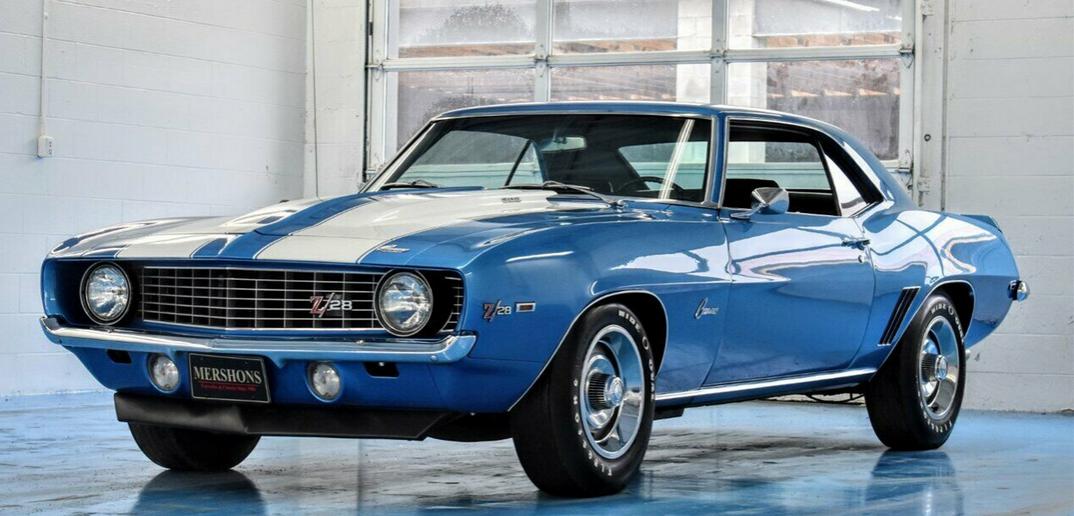

https://www.ebay.com/itm/1969-Camaro...cAAOSwhadfypTK
Link to Dealer web site, More pics and info......
https://www.mershons.com/vehicle-det...aa632c0664b2bc

Lipstick and makeup come to mind here. Just a once over and many things are obviously very poorly done, or very wrong.
  • Seat covers fit horribly...
  • Wrong shifter handle...
  • Missing center clock in the dash...
  • Rear tulip panel seams are filled in...
  • No engine, trans, or rear-end stamps...
  • No trim tag pictures...but in the video, it looks really questionable?
That was just a once over and I haven't looked at the engine or underside to pick it apart. Already seen enough to make me think it's a put together car with nothing substantial being offered here.
Walk away and keep looking is my advice.

Looks to be a early pre X code TT. Be very cautious at that place. JMO

1badZ28, the TT posted in your pic is non OEM. Stay away.

ditto the above, especially that the trim tag is a fake.
Really crappy body work and paint. At least they painted the grill silver... but forgot to paint the headlight buckets silver.
Car did not come from the factory with console gauges.
Cheap generic rear springs.
Not even a good attempt at restoration. If the tag is fake, then likely everything else is as well.
