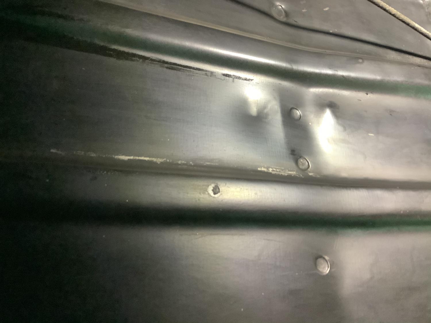

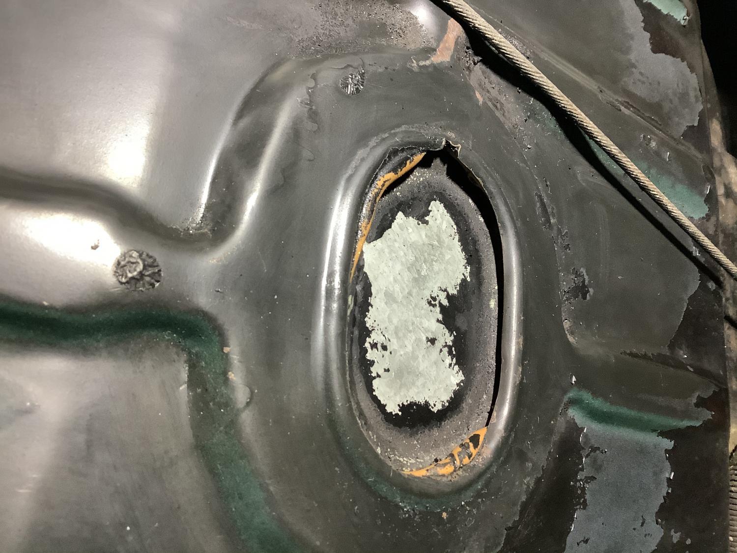

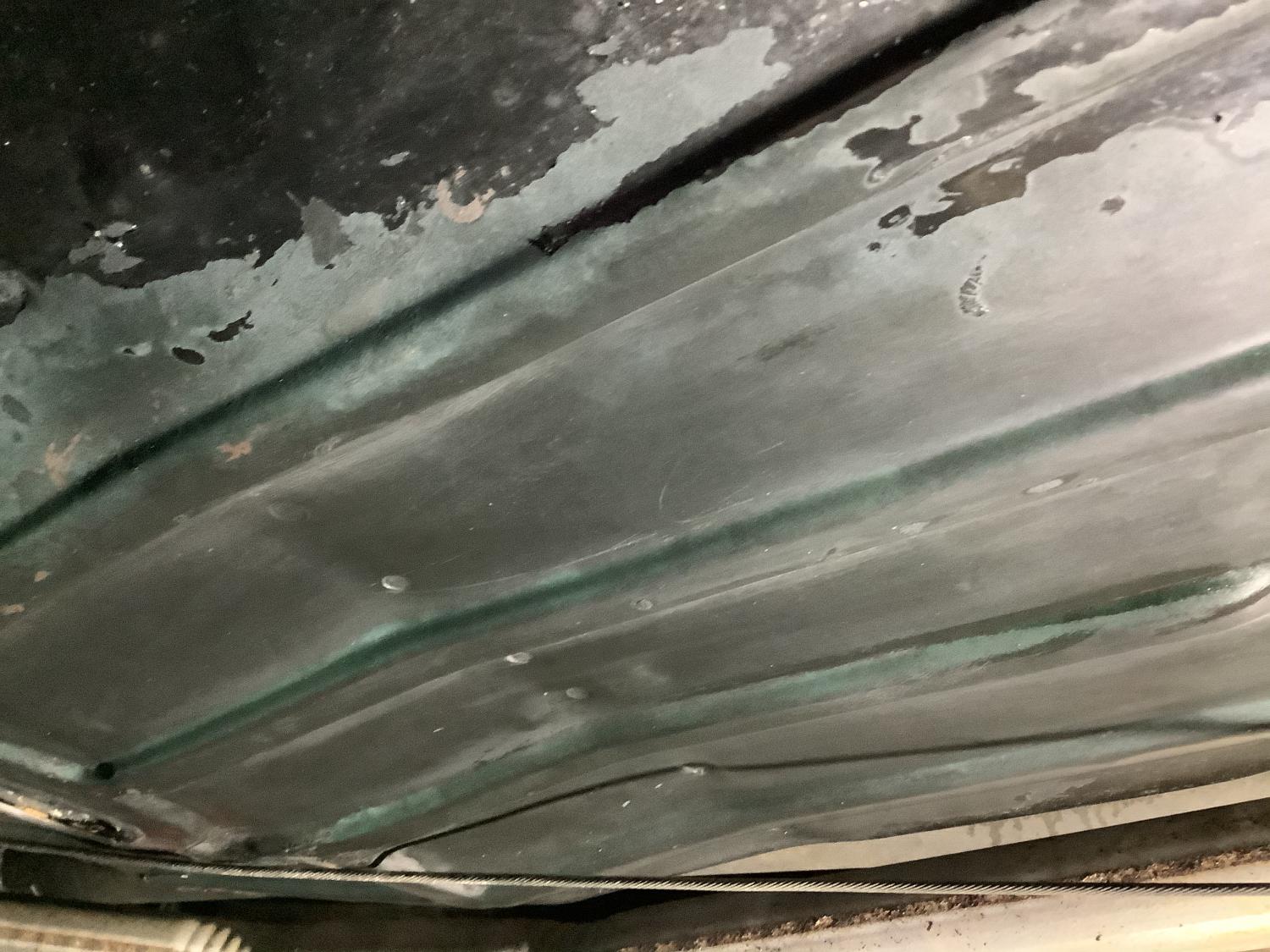

I decided to work on the undercarriage of my 14,000 original paint 68 Z. Unfortunately, it was spray bombed by the original owner in the early 70’s. I decided to open up a can of worms and try to clean the back spray paint off of the floors and hopefully not harming the original finish. A friend of mine recommended I try “Naked Gun” spray gun paint remover/cleaner. The stuff worked amazing. I sprayed it on, waited five minutes for the black spray paint to alligator skin and then I wiped right off. It did not hurting the original paint and factory overspray on the floors. It also did not leave any film afterwards.
I have a long way to go, but I thought I would share some pictures. These pictures are after about thirty minutes of work.
If anyone else has any suggestions on spray paint removal, please let me know.

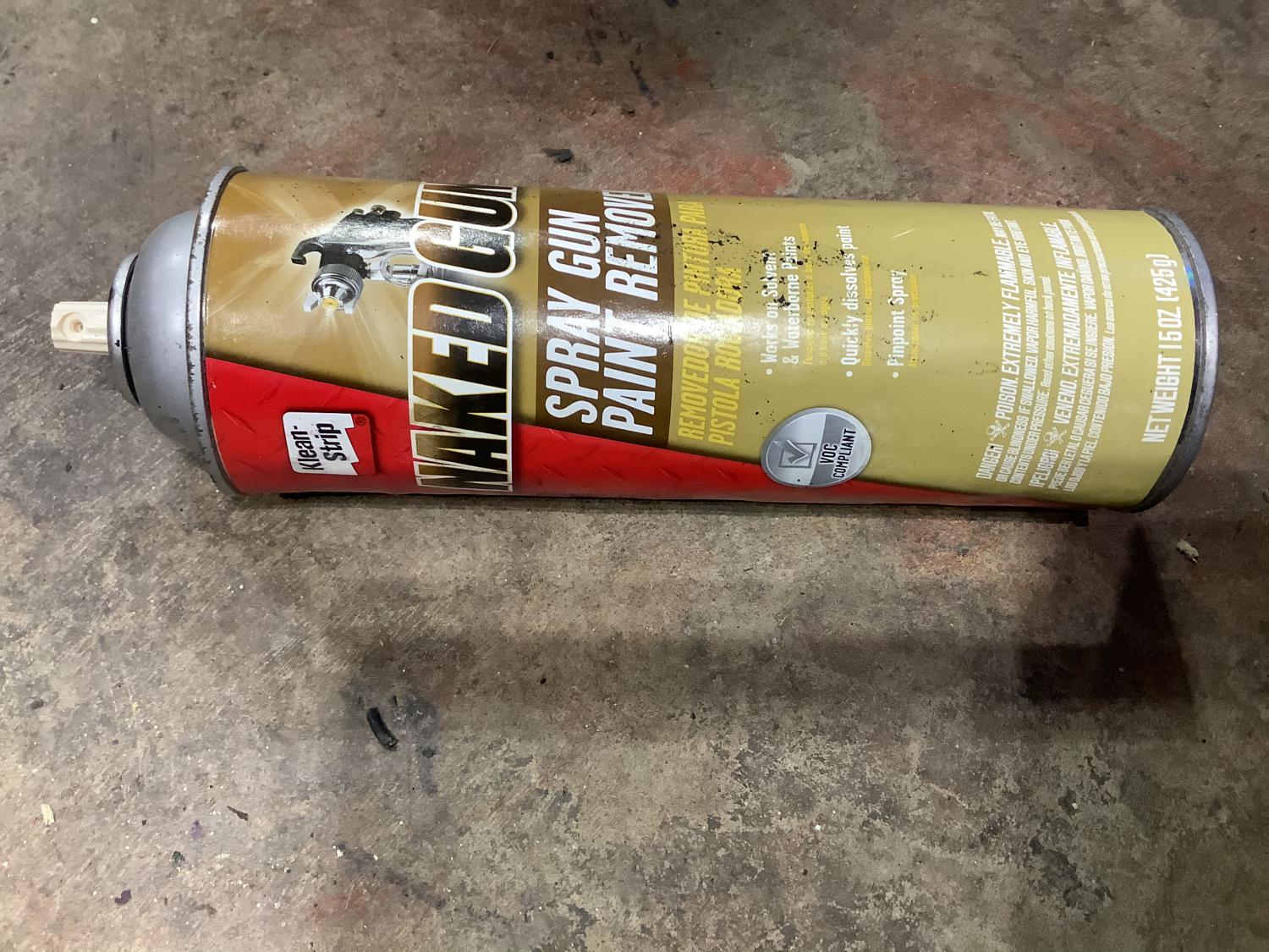

Naked Gun Spray Gun Cleaner

Sounds like Zip Strip in an Aerosol can.
