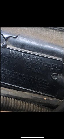

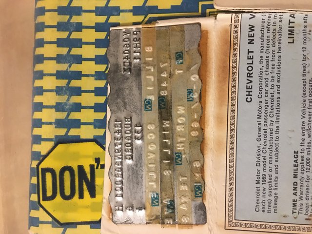

Very cool car sold new in Weatherford, TX and still has its original POP from Ferrill Chevrolet. I'm guessing it will sell for close to the ask based on the color combo.
Link to 1969 Z/28 auction
124379N662001

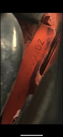

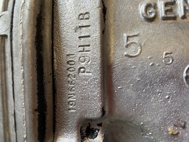

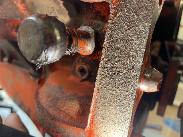

Not much info, missing and incorrect items. How about a few pics stampings and trim tag, X77 trimmed as X33, repop door panels, alt painted silver, fuel pump, headers, full dash woodgrain and misc plating and hardware. It looks like a nice car, but there needs to be time and expense put in the car to correct the above issues. Not sure why so few pics of critical items when asking 70+k.

Agree Steve. Car has a lot going for it, but also has some issues. I don't mind the added trim so much; even considered adding trim to my black Z. In retrospect, glad I didn't.
I really don't like the door edge guard on a black car. Messes with the lines. Don't like the black paint on the alt pulley or the polished valve covers.
And of course, like Barry says, what's with FW wheels. A set of five matched YH wheels are gonna be pretty expensive.
But, as you say, why no pics of the stampings? At 77k you expect to see all the goodies. I am sure I missed a few things.

Here you go.

Not great pics of TT and engine stamp but like what I see... Thanks for posting
