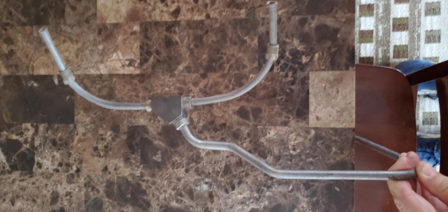

Rear intake hole should have a fitting for the Power brakes and then another port for the vacuum take off.

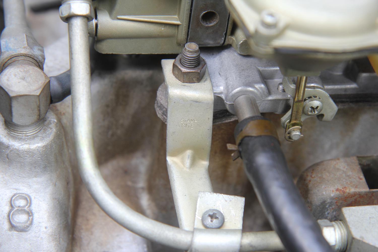

Here are photos of the fitting and the pipe which bolts to the throttle cable bracket.
The first photo was taken the day the car arrived and The STAMP RITE bracket should have had an indented hex head screw not a pan head phillips. (it is correct now)
