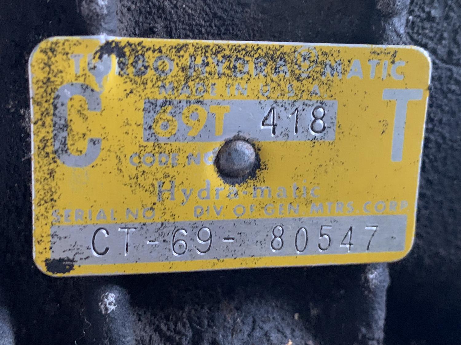

Hello,
Any idea of the application on this Turbo 400 I picked up recently?
It says 69 CT, i remember hearing that the yellow tags were Hi-performance trans applications?
here is a pic, trans supposed to be in working order with TQ Convertor still attached.
Thanks in advance for any help!
Jerry

There should be a partial VIN on it some where. Maybe on the mounting flange or above the pan rail...Joe

I believe that's from a pickup truck.

Old 03-08-2021, 01:31 PM
WILMASBOYL78's Avatar
Join Date: Jul 2003
Location: new york
Posts: 8,346
Post Chevy Pickup Trans Codes..
http://www.teufert.net/trans/t-400.htm
This link should help....
-wilma

Old 03-09-2021, 04:44 PM
lbnaz lbnaz is offline
Yenko Premier Member
Join Date: Jan 2004
Location: Tucson, AZ.
Posts: 1,117
Thanks: 658
Thanked 156 Times in 81 Posts
Wilma, do you have any info for Chevrolet prior to 1971. The link shows Buick and Pontiac back to 65 but not the Chevy list. Thanks, Larry
Old 03-09-2021, 06:25 PM
Join Date: Jul 2003
Location: new york
Posts: 8,346
Post Th 400...
https://www.tpocr.com/chevrtc.html
try this....

Old 03-12-2021, 02:01 PM
Woj's Avatar
Woj Woj is offline
Join Date: Nov 2005
Location: Cleveland, OH
Posts: 1,872
Thanks: 1,064
Thanked 447 Times in 171 Posts
That is for 69 Chevy truck. Auto trans tags on TH400s (Chevy) were yellow in 1969.

Old 03-12-2021, 10:01 PM
Posts: 20,896
Assembled February 21st 1969.
