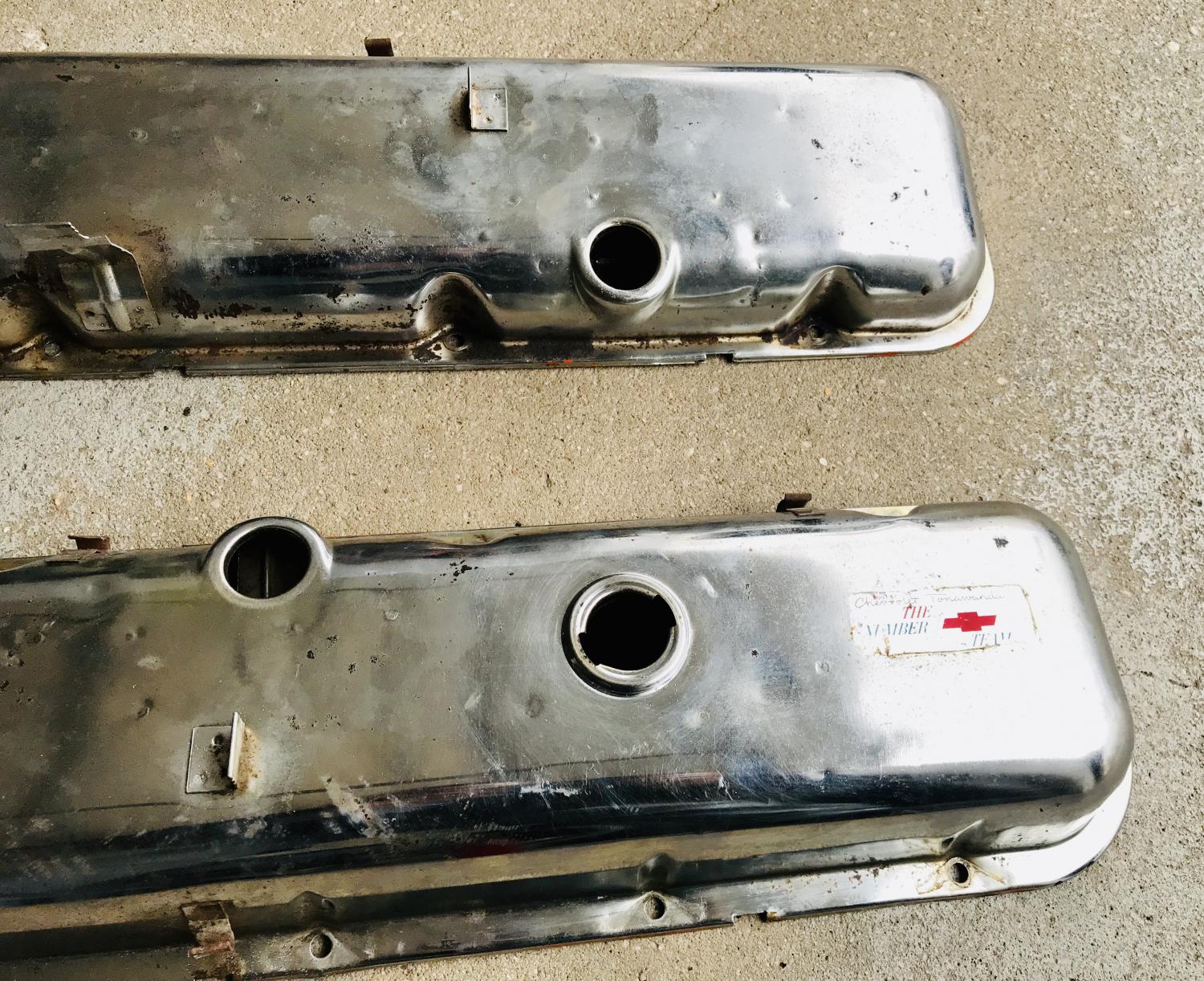

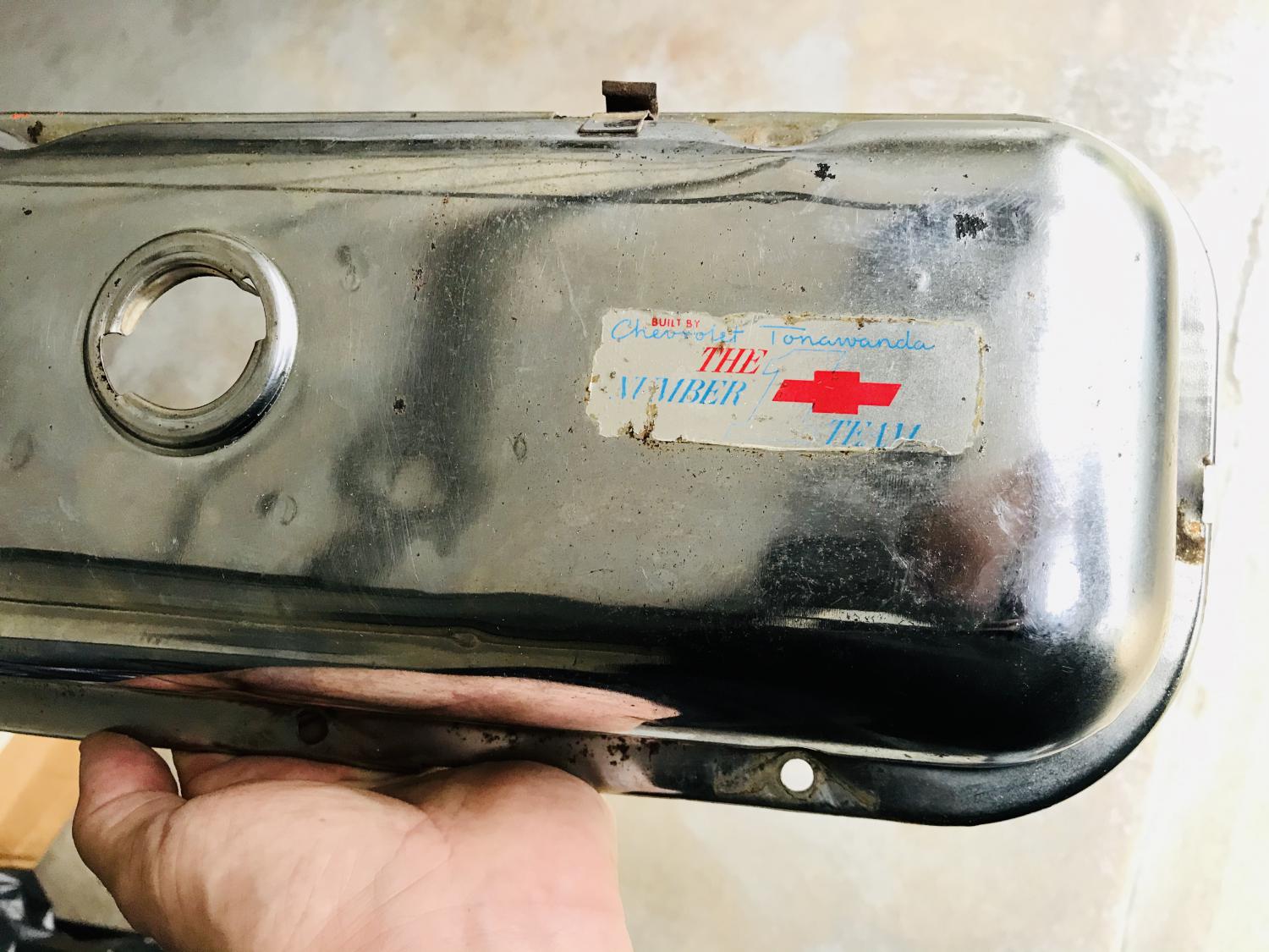

I have what I believe to be 1969 L78/L72 valve covers that have been in storage since the early 2000s. I also have the hold-downs & bolts that were removed with these valve covers. There are 2 different markings on the bolt heads. I would like to know which hardware (if any) are correct, and also if the valve covers are indeed 1969 Camaro pieces. Thanks!

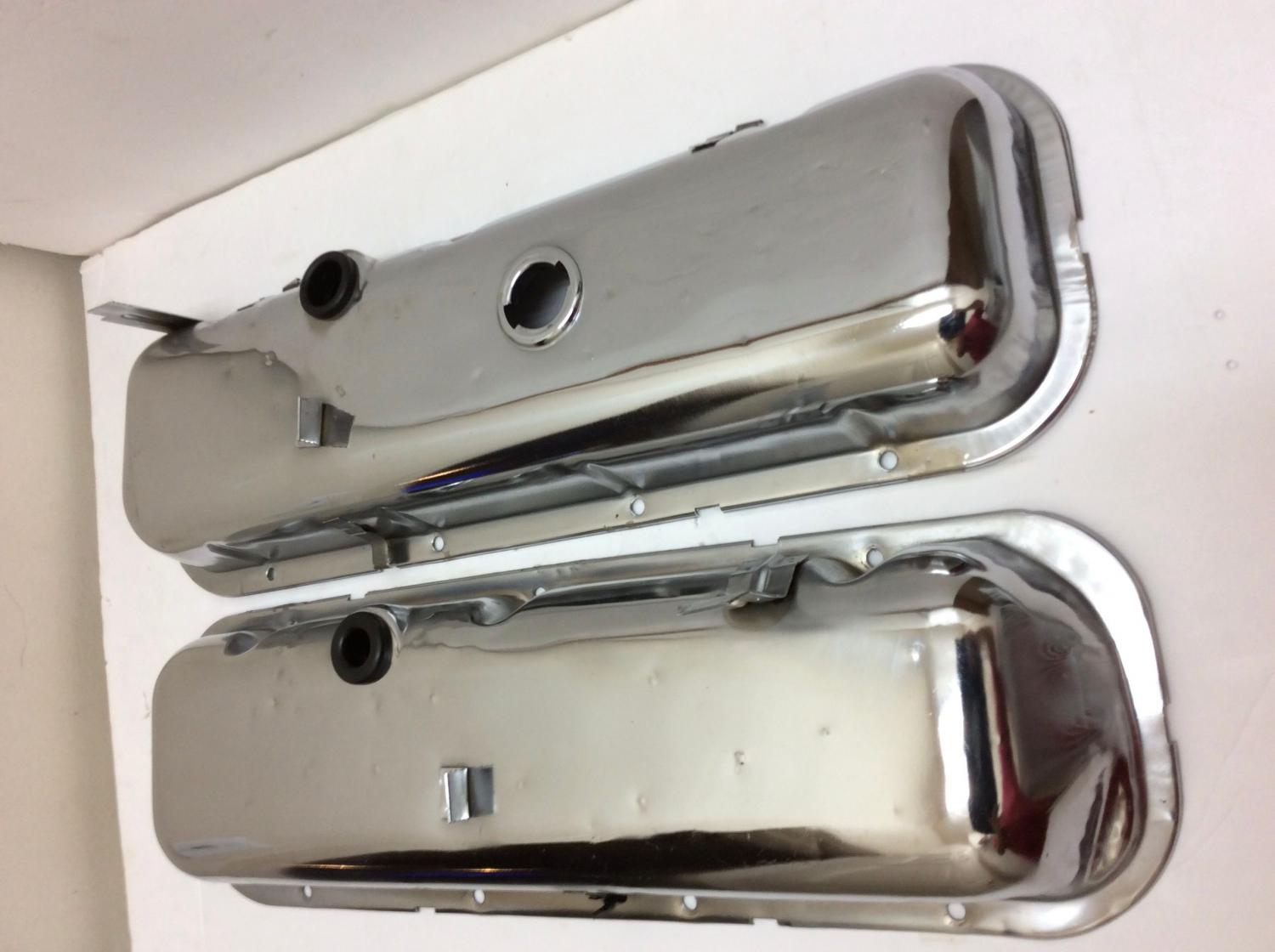

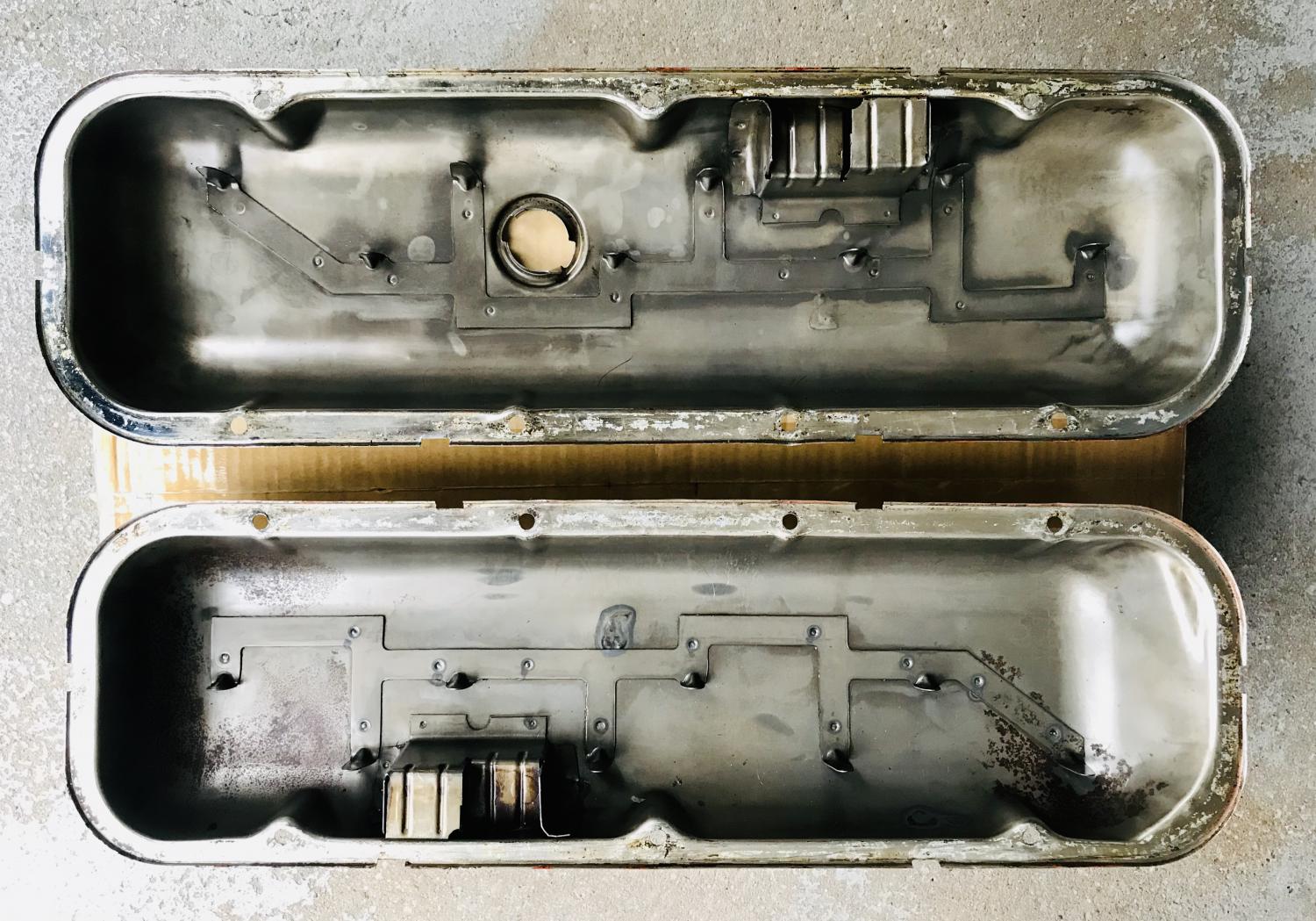

Those are definitely not 69 Camaro, those are 1970 only Chevelle or Nova L34, L78, LS6.
Thanks! Is the difference in the slanted corner?
The slanted corner on the left side rear & the 3 wire clips on the right side.

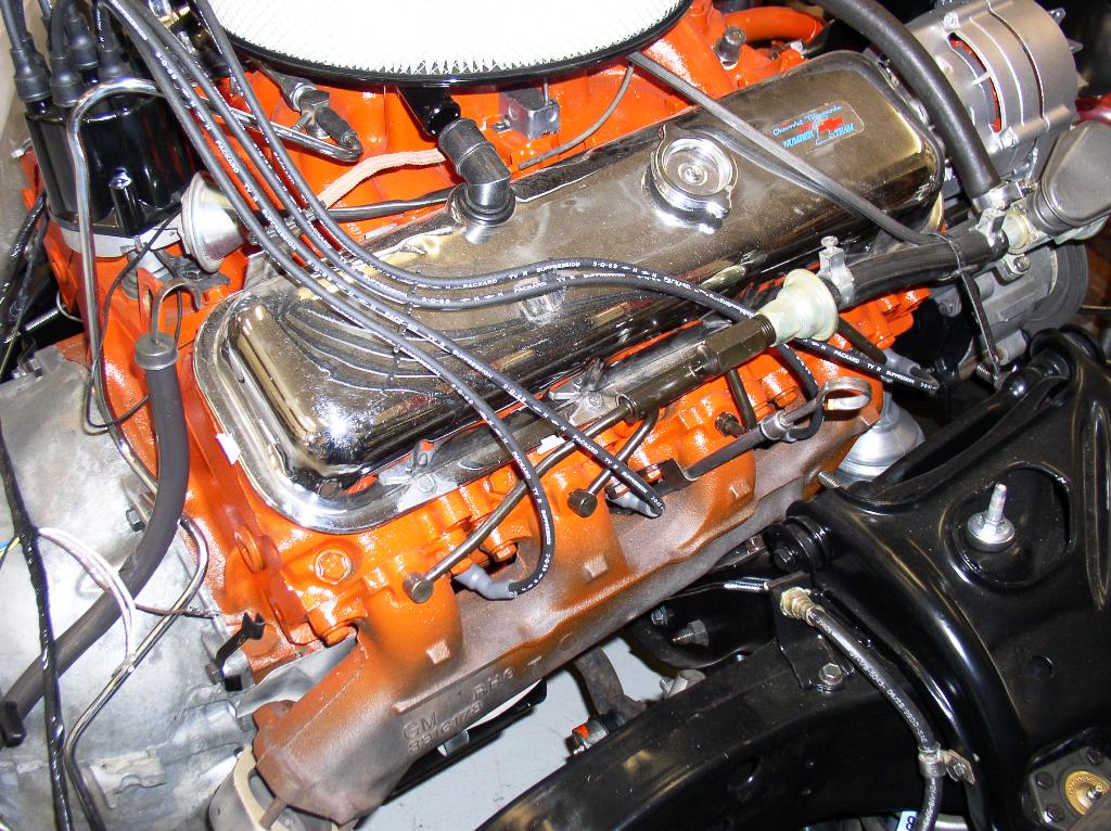

My late 1969 Camaro has that valve cover...always has. Engine number is T0821CJG....Joe

RH cover has no clips...Joe
