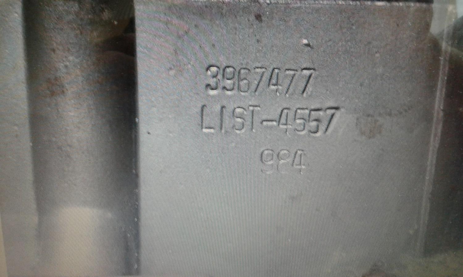

Is this holley carb stamp legit?

It's real. Early stamped carb for a l78 car.

'70 L78 and LS6 specifically

That stamp is beautiful,1969,August,4th week.
Waaaaaaaaaaaaaaay to early for an LS-6 Chevelle.
1970 L-78 Chevelle/El Camino & Nova 4spd. only.
