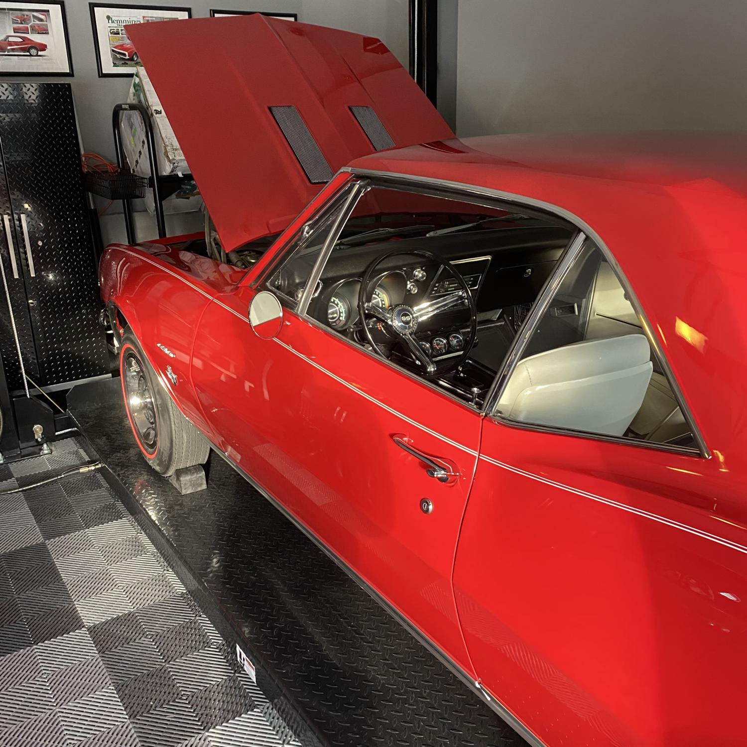

I was overzealous with the gas this morning and flooded the carb. What’s your cold start procedure if the car has been sitting for a few weeks/months?

Attachments - The Supercar Registry t1.jpg D67803F5-8C7A-470C-A75A-F6702E5DAD31.jpg A8CB37AC-BBE5-4756-A1F6-117D25D801CC.jpg
