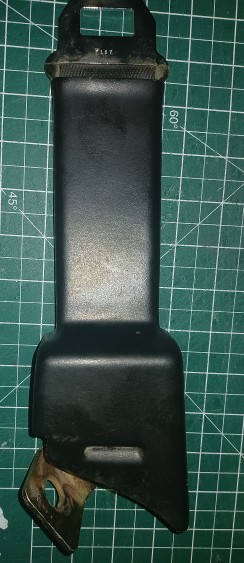

Default Seat belt guides
On my 71 Nova with bench, there are seat belt "guides" that feed the belts up through the seat. They are made of plastic and hold the belt/buckle from the floor up to the buckle.
Does anyone know where these items can be sourced/obtained?
Thanks ... Craig

AFAIK, they are reproduced by no one. Used seems to be the only choice, and finding decent used ones is not easy.

Thanks - I have those pieces ... need the "tubes" the seat belts go through from the attach point to the buckle ...

Got,cha you must be referring to the seat belt retractor cover , the hole assembly has to be replaced because the steele buckle is wider than the opening in the plastic cover unless you remove the buckle and resew it. This is a replacement for my nova in the pic below .

The retractor cover on the 69 Camaro is a little different, but I was able to remove and reinstall it by heating the cover in hot water, making it much more pliable. As I recall, it was still a challenge, but doable.
