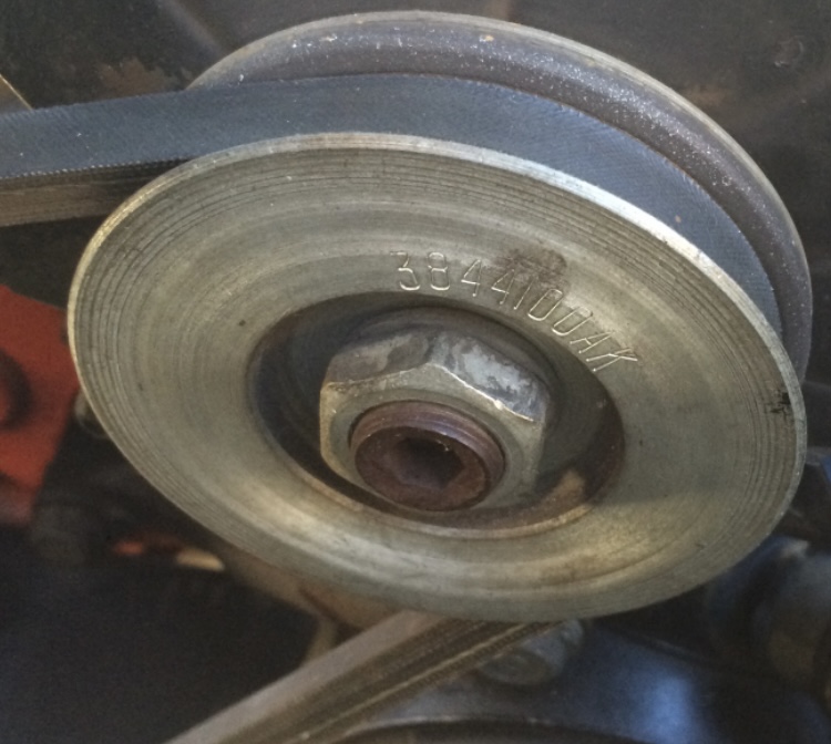

Looking for photos and dimensions of an assembly line 3844100AK alternator pulley. Bonus if you have one to spare.

Here ya go

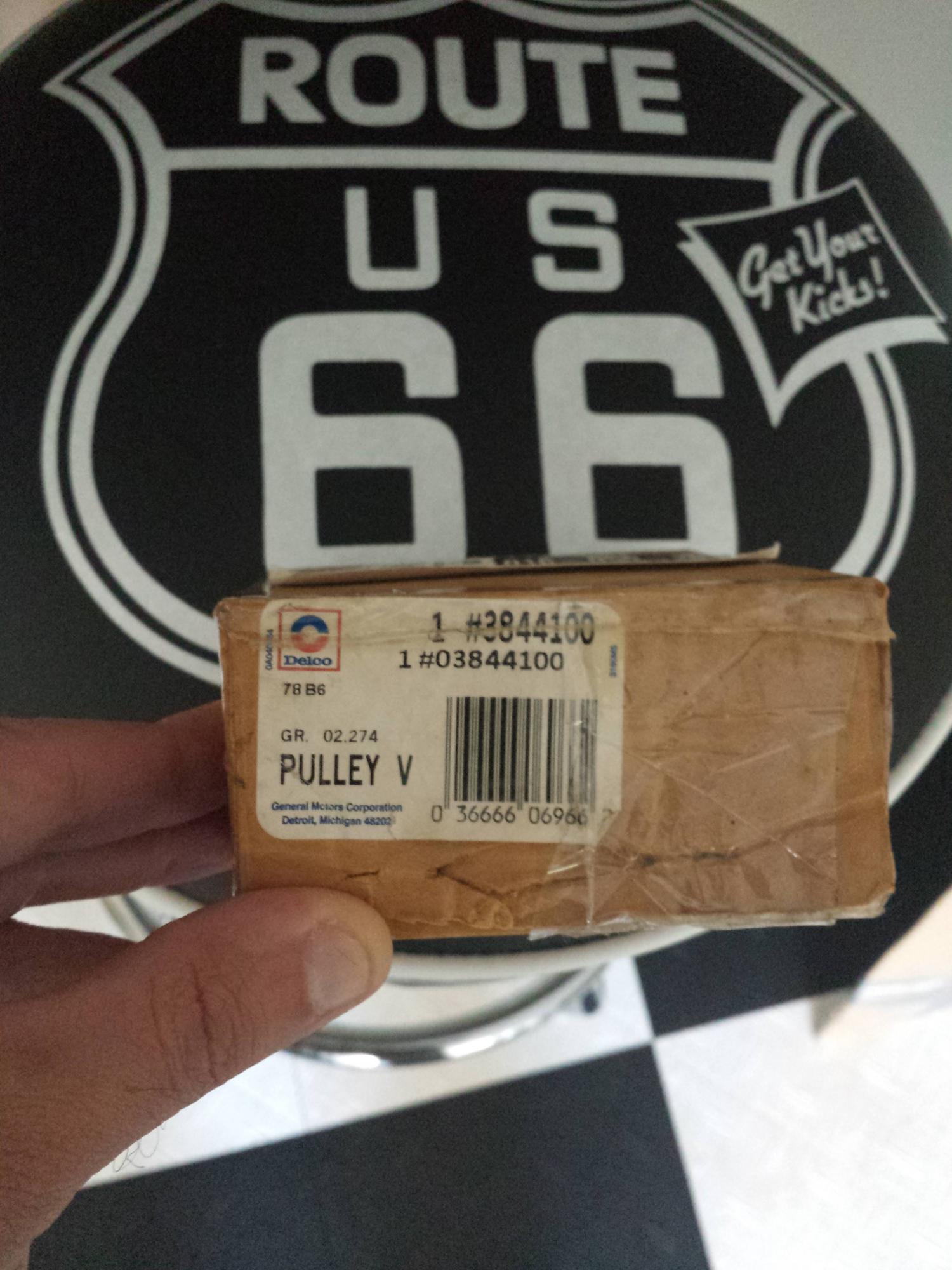

The NOS in box ones don’t usually have numbers stamped

The dimensions listed in the 7/1/1967 parts book were:
Outside diameter: 3-7/32"
Shaft [hole] diameter: 43/64"
Groove width: 1/2"
I can only speak to 65-67 Chevelle usage, but this was the factory pulley on 65 Z16's and 66-67 L78's. It also came on the 62 amp "AC generator" option in 65 and for at least part of 66.
Some assembly line pullies were stamped, some weren't. I do not know if that was a matter of two different suppliers (each supplying different assembly plants), or a timing matter. I can only say for sure that
- the pulleys on Z16's (all built at KC) were not stamped,
- I have seen some original 66 Chevelle L78 pulleys that were stamped and some that were not, and
- so far I have never seen an original 67 Chevelle L78 pulley that was stamped.
65-67 Originals were all cad plated. Later NOS replacements are cad-dichromate or zinc-dichromate (the goldish colored plating).

If there were two suppliers (one stamping and one not), then I think you would need to get advice from someone who owns or has pics of an unrestored Norwood L78 to be sure.
If it was a timing thing, then I would say unstamped is more likely correct. As I said above, I have never seen a verified original 67 Chevelle L78 pulley that was stamped. Here's my Baltimore July built original, as found before the car was awakened from a 37 year garage slumber.

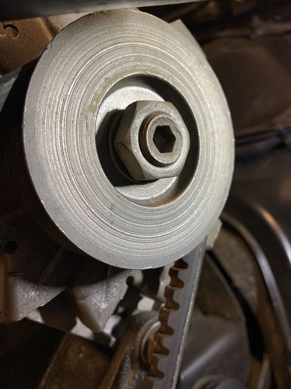

I have received photos of my original L78 04D engine as pulled in the late 60's early 70's by the original owner. The last photos are closeups of the alt and pulley now as provided by the current owners of the engine. The pulley is definitely a 3844100.
However it does NOT have a stamp but as previously discussed on CRG, later NOR cars appear to have a stamp.
I include this data to prove early NOR L78 cars also used the 3844100 as illustrated in the AIM. Perhaps leftover pulleys were used from Chevelle production for early cars?
