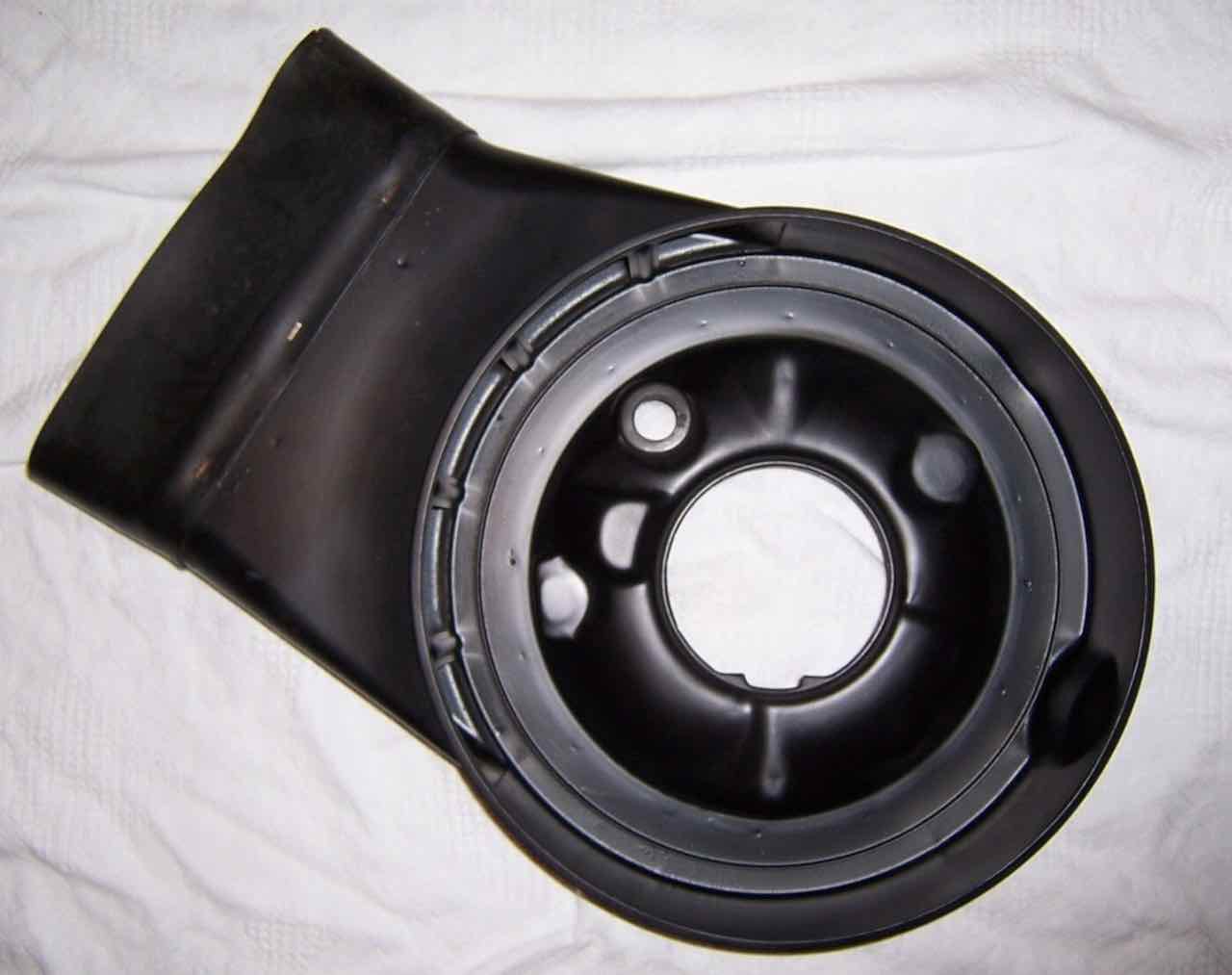

I've been curious about the differences in cowl plenum air cleaners and how they may change between body platforms.
For instance, on Doug's 67 Yenko, is there a difference from a small block to a big block? A bodies to fullsize. Etc....
I've been looking around on the web, and cannot say I found a good source of info.
Sorry if this is kind of a remedial question. I'd just like to know more.
In advance, thanks!
Tim
Attachments - The Supercar Registry Chevelle 5 window base.jpeg Camaro 4 window base.jpg

A cowl plenum air cleaner for a small block will have four "windows" in the area that would lead toward the duct. A big block cowl plenum air cleaner will have five of these "windows", and the metal extension with the rubber seal on it will be a little wider and longer. Also, the big block version has a small notched area on the driver's side that provided clearance for a breather cap on the LH valve cover. A notch at the front of the cowl plenum air cleaner is for clearance for the '68 smog pump. The '67 air cleaner does not have a notch up front because the smog pump and hoses have enough room without it.
