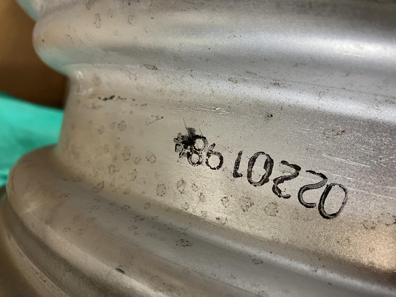

Default Black stamp
Like this? If so what date do these decipher to please.
Thanks,
Richard
1967 Camaro SS 396/375 4K
Old 01-07-2023, 11:34 PM
1967 4K's Avatar
1967 4K 1967 4K is online now
Join Date: Jul 2012
Location: Ky.
Posts: 1,003
Thanks: 4,162
I got it February 20th 1984. The 4 is hard to make out.

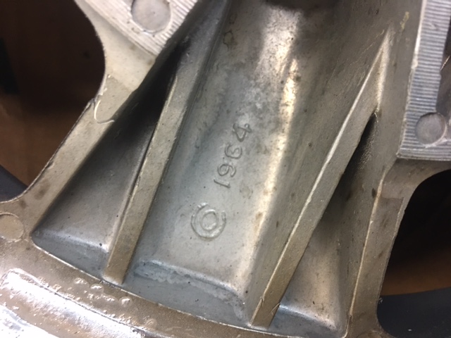

Default Clear date
This is a NOS 15x8 i have. Found this picture I forgot about having. Pretty clear about this date.
Zoom in on this pic and you see Mexico Marco. All the wheels I have say that. Yea I understand probably made in Mexico but what’s Marco?

Date codes are stamped, either by being punched or ink stamped into the hoop. The embossed numbers on the back of the spokes are copyright info. Depending on the year of the wheel, will determine where it was manufactured. Some say Mexico, some say USA, some say Firestone. Don’t be fooled into thinking you have a 1964 wheel due to the numbers that are embossed/cast on the backside of the spider/spokes…many do think that, but it isn’t so.
