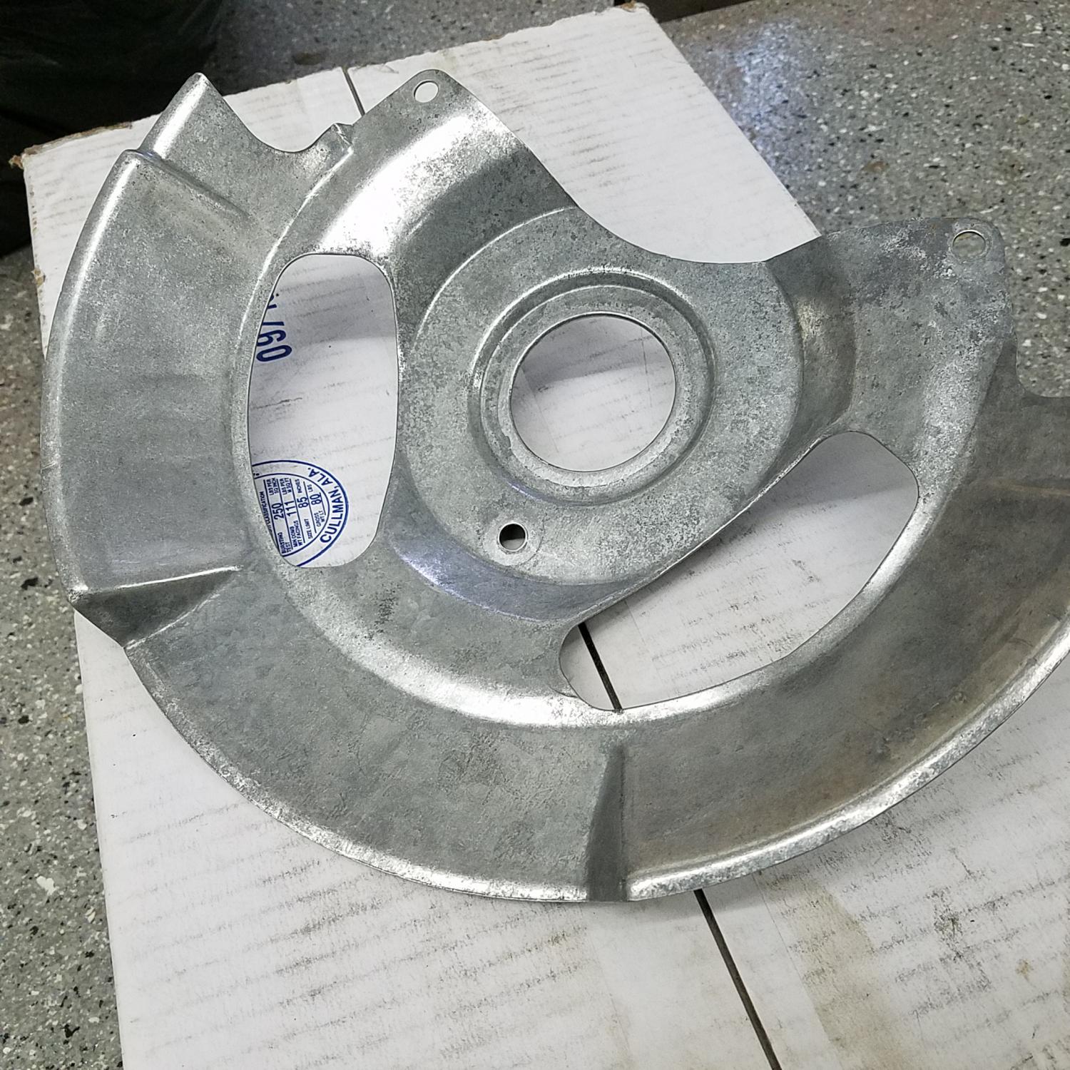

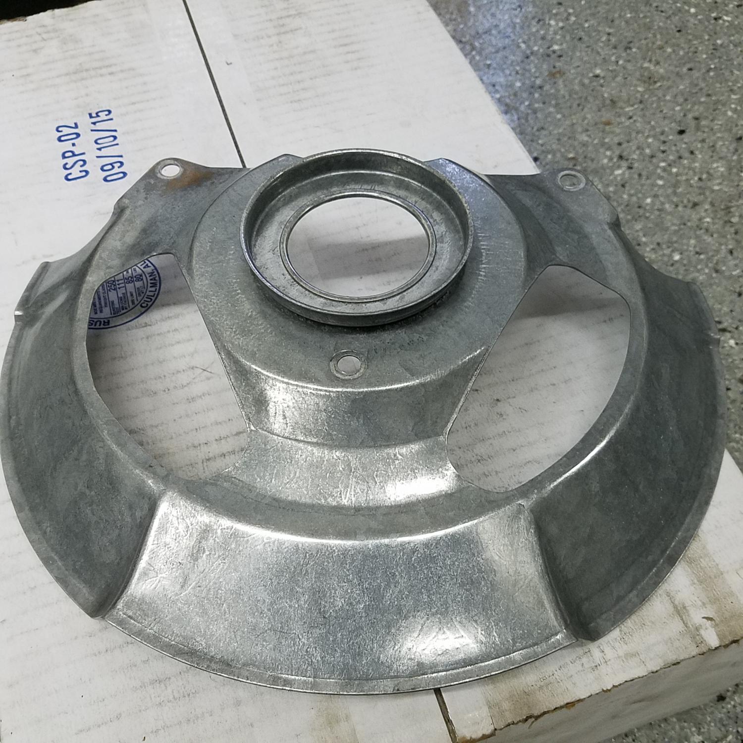

What was the factory finish on factory splash shields? I always thought they were galvanized? Any pictures would be appreciated. Thanks

Galvanized Dust Shields

Galvanized is correct for original dust shields. Since this type of plating is not widely available silver zinc/cad is being accepted.
