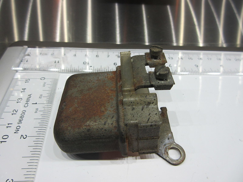

Just removed a 862 off a 54,000 mile 69 z-28 As you can see it have the Black base vs the clear base Its a 03D car. Or a 890 ????? Any thoughts ??????? joe

For a Feb & Mar car the 862 horn relay had black plastic just like the 890's. Most likely a transition thing. My black 3B Z had a 862 with black base and have seen a few others.

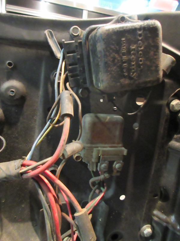

Seems the January - March production period saw more than its share of transition parts, here is the original 862 relay from my 2B Norwood RS/Z, it has a clear base. The car was also equipped with a shorty spoiler and stainless trimmed front turn signal lenses.

My 03D car has a black base.

862 With Clear Base
