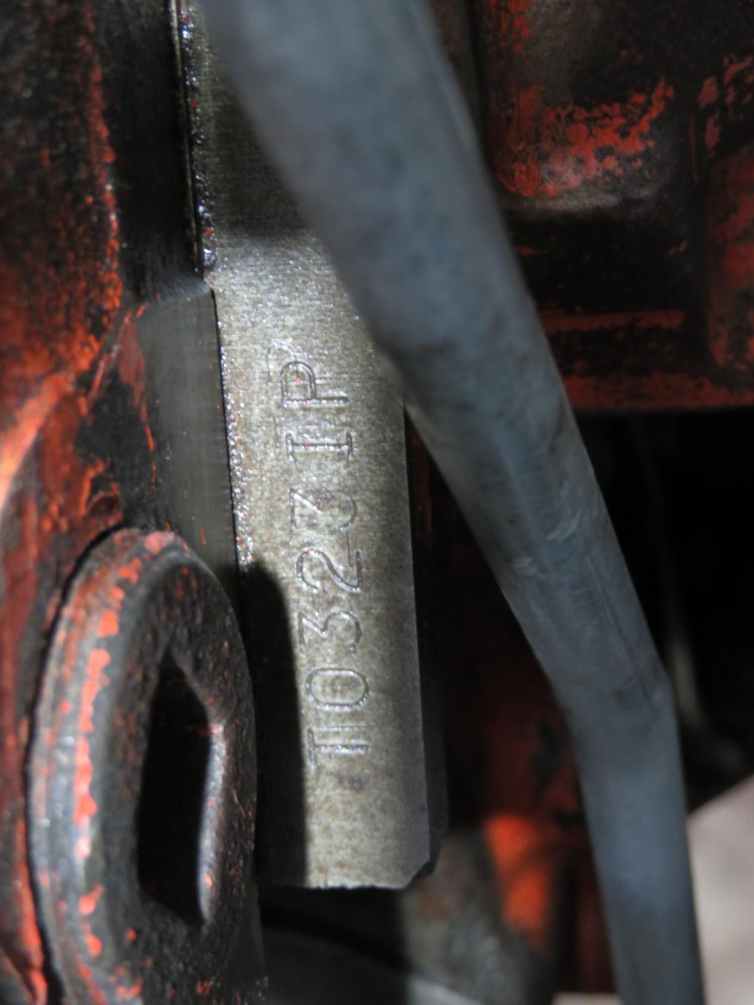

That stamp is awfully straight. While this stamp from my old car is 6 months later, I think lack of character alignment is typical
Looks like ghost stamping underneath.
On Tim’s pic? That is a typical double stamp from the stamp hitting the pad, jumping back and hitting the hammer, then hitting the pad again. Look more closely and you will see it is the exact same stamp just slightly higher and to the right.
