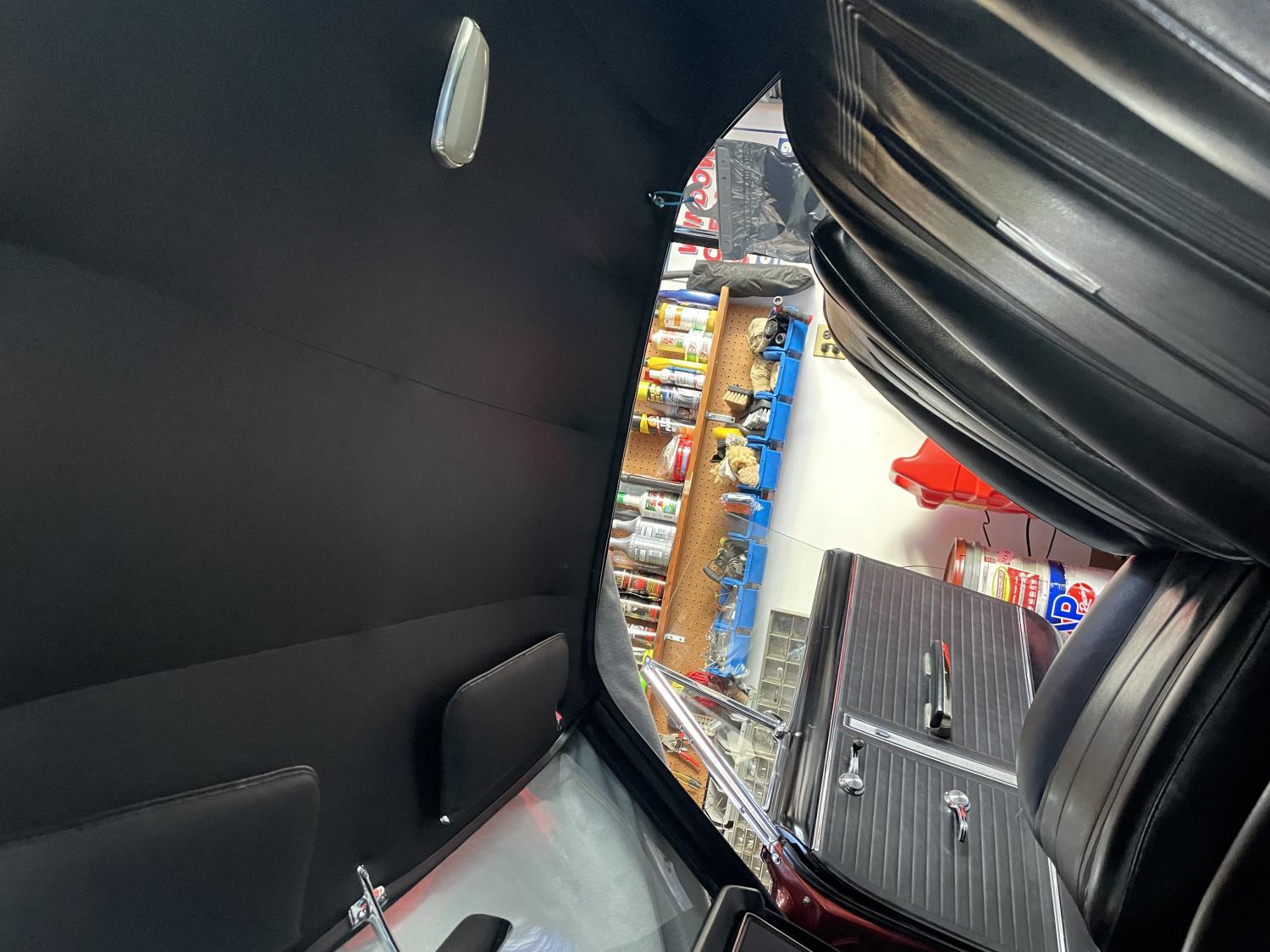

Finish product

Old 02-12-2024, 10:25 AM
dykstra's Avatar
dykstra dykstra is online now
Join Date: Oct 2009
Location: Washington, IL
Posts: 2,644
Thanks: 30,112
Thanked 2,641 Times in 1,262 Posts
Looks fantastic!!
