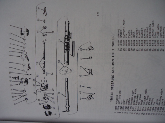

Looking for a schematic for a 68 or earlier tilt steering column. Application is for a 68 Camaro but any GM will do other than telescoping or Corvette. Lots of info for 69 and up locking column but can’t find any for 68 and earlier.

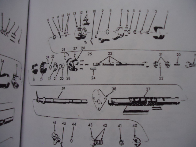

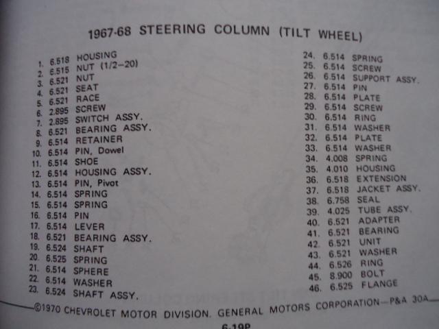

Old 01-10-2024, 07:47 PM
Posts: 20,896
This from my original 1970 Chevrolet Parts & Accessories Counter book that is 10" thick.
