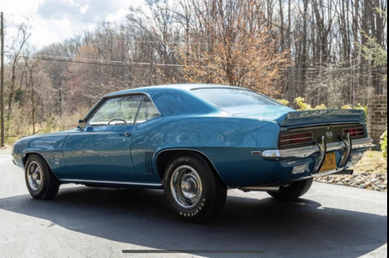

https://bringatrailer.com/listing/19...maro-rs-ss-48/
Its half RS and half SS
Do your homework!!!!
124379L511806
Attachments - The Supercar Registry 8813C680-4E12-473F-8B61-E3BF7FB70895.jpg

With some day-two wheels and rubber, this Camaro might have a nice stance... but with the rally wheels and Polyglas tires, it just looks wrong (IMHO). Why is that?

Ivory Vinyl interior? Where I come from it's called Parchment!

Man those docs are suspect and i see all kinds of stuff on those pics that screams walk away if u are looking to purchase as a real car!! But the car dose look good.

The invoice is a fake. I'd have to see better pics of the pad and trans, but.....

I have seen it in person at cars and coffee here locally it is restamped engine pad for sure after that observation I didn’t even go under the car to check any other stampings... someone will be very upset if they buy it as advertised “numbers matching.”

Well the seller is playing dumb here. Bidding is at $50K.
Im not seeing a $50K car here with questionable stampings and very amateur resto.
Not alot of upfront disclosure IMO.
Cut out hole for 4 speed doesnt look right.
Invoice shows ZL2 for $79?? on a 12A built car??
lots of stuff not adding up here
