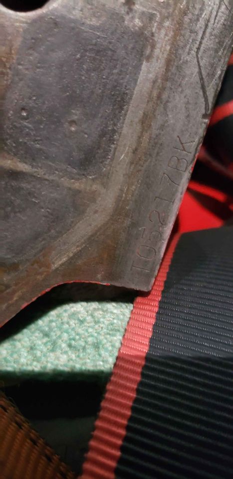

Someone of Facebook posted this picture looking for information on the engine in his 1969 Corvette. I couldn't find anything on a BK code big block. Anyone know anything about this engine? He said it is a 4 bolt 512 block with 842 aluminum heads.

BK boat code

Yes, the 7XX suffix is marine originally.

Originally Posted by BARRY View Post
BK boat code
Boat Kode...
BK boat code
From what I remember:
B Code: Boat Code
C Code: Car Code
T Code: Truck Code

Thanks for all the responses. I relayed the info to the guy with the engine
