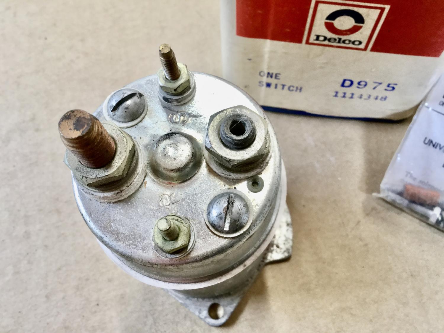

These manifolds barely clear the chassis and get extremely hot so a stainless steel shield is fastened to the top of the starter solenoid. The HO solenoid is a first year design “348” with a solid steel cap, unlike the brown Bakelite found on other solenoids.
A special engine wire harness is used that has the two starter wires routed in a long U turn. Up to the front of the LH side of engine, down the front and back to the starter traveling through an oval metal tube fastened to the top of the LH engine mount. This also requires a special positive battery cable that goes through that starter wire tube. These are a PITA to deal with when servicing a starter.

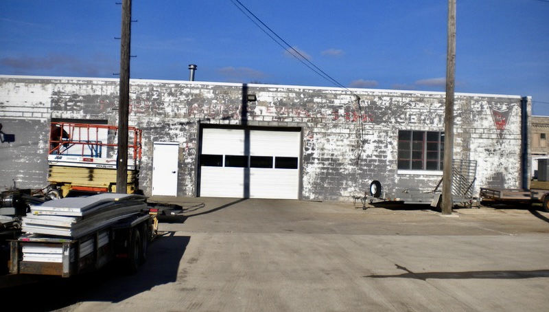

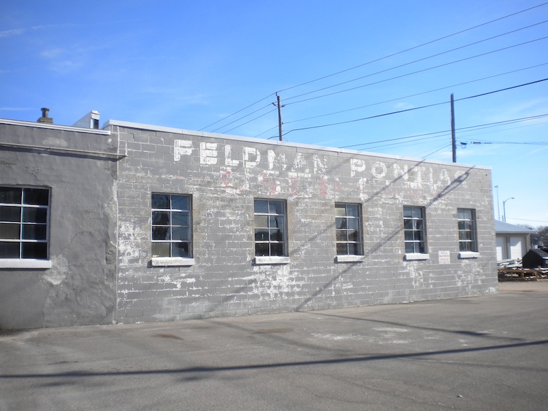

The Feldman building has housed an overhead door company for decades, I snapped some pix while being prepped for paint a few years ago. - Bill W

Morning Bill,
I’d say you were fortunate to have been in that neighborhood at the time someone was prepping the building for paint to capture those historical photos.
I tried to clean up the two photos a bit.
First one is obvious.
Second, not so much other than the Pontiac crest.
Thank you for these vintage pics to go with the ‘67 HO.
