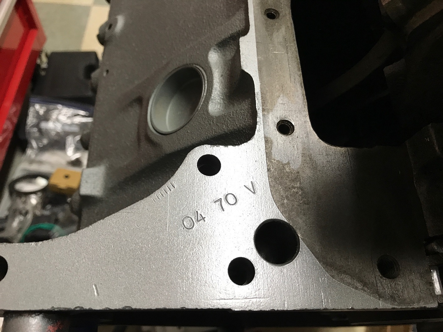

is there any way that the ce build stamping tell you the build date or is it just a sequence number
Attachments - The Supercar Registry CTZ CE block stamp under starter 1.jpg CE stampings 1.jpg CE assembly date.jpg

Look under the Starter Mounting Pad for the Assy Date stamped in the machined surface

Default My 1969 CE 302 Warranty Motor for my 68Z
Example

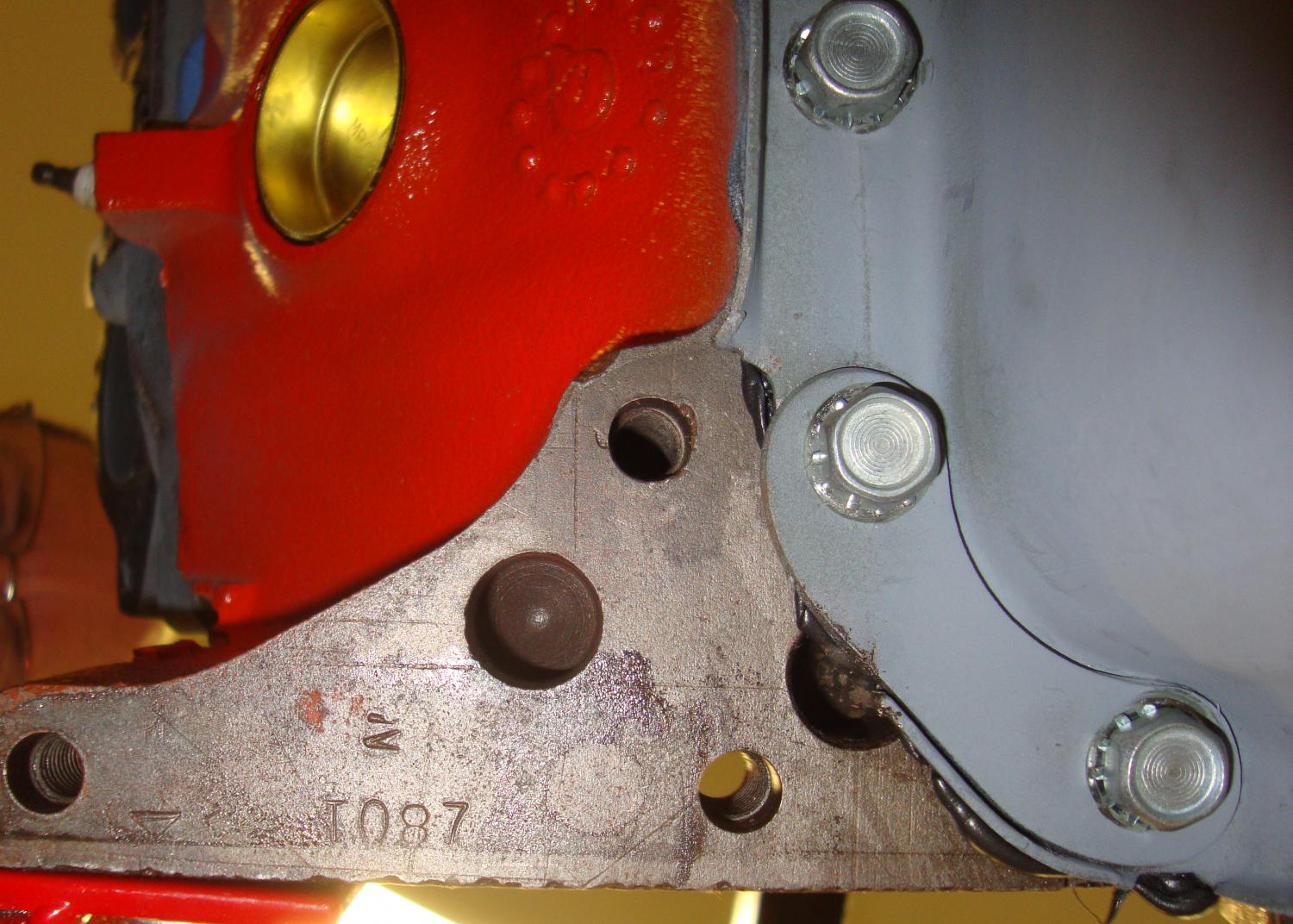

Default My 1968 CE Motor (L78)
Sample of a BBC

And note the "V" and "T" indicating the engine plant.
