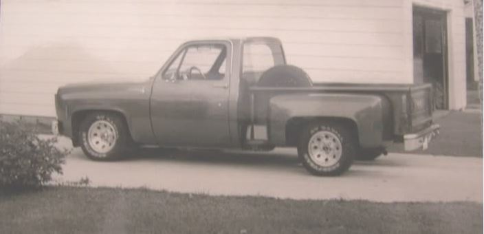

One more and then I'll quit:
I did not remember this but in the '73-77 timeframe you could not order a LD squarebody pickup in "black". It was not available as a regular production option.
You could, however, order it as a COPO and tap into Specialty Equipment Option 9V1 and access the black available for fleet and Medium Duty trucks.
We had a '75 2wd Short box in black, but I did not remember dad saying he had to do anything special to get it.
It became a regular option in '78.
K
