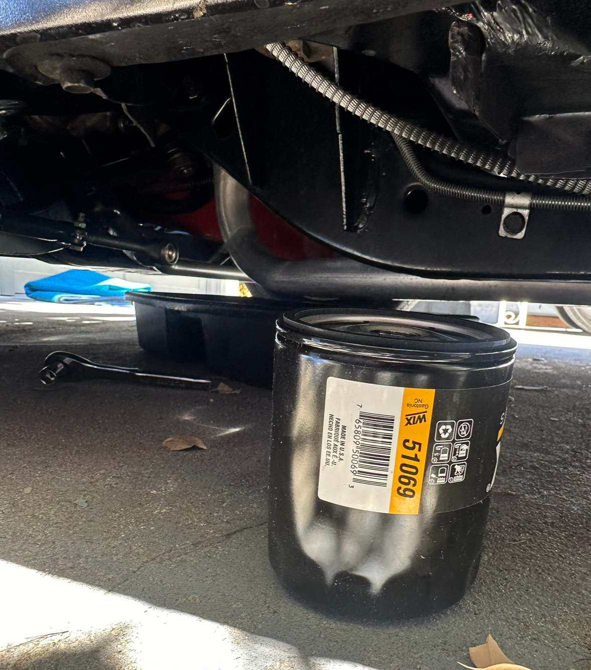

I will soon be draining the break-in oil (BR 15W50 recommended by the machine shop) from my flat tappet 454. What are the experts oil recommendations for this engine? Thanks in advance! Craig
