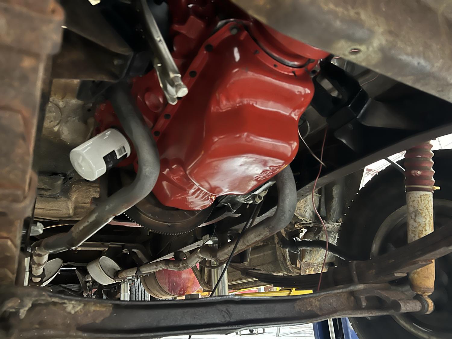

I'm in the process of putting a clutch in my 69 D300 and while the transmission is out, I am fixing the oil leaks coming from the pan. Do you guys have a certain method of installing the gaskets & pans to eliminate the leaks? I have the Fel-Pro 4 piece gasket set with the cork pan rail gaskets and rubber end gaskets. I have thoroughly cleaned the pan and have straightened the pan rails.
I have heard to use high tack on the pan rails to glue the gasket in place and to use a small dab of RTV were the cork gaskets meet the rubber end seals. Leave the block side clean and dry and reinstall. If this is not correct, I would appreciate any feedback you guys can provide.

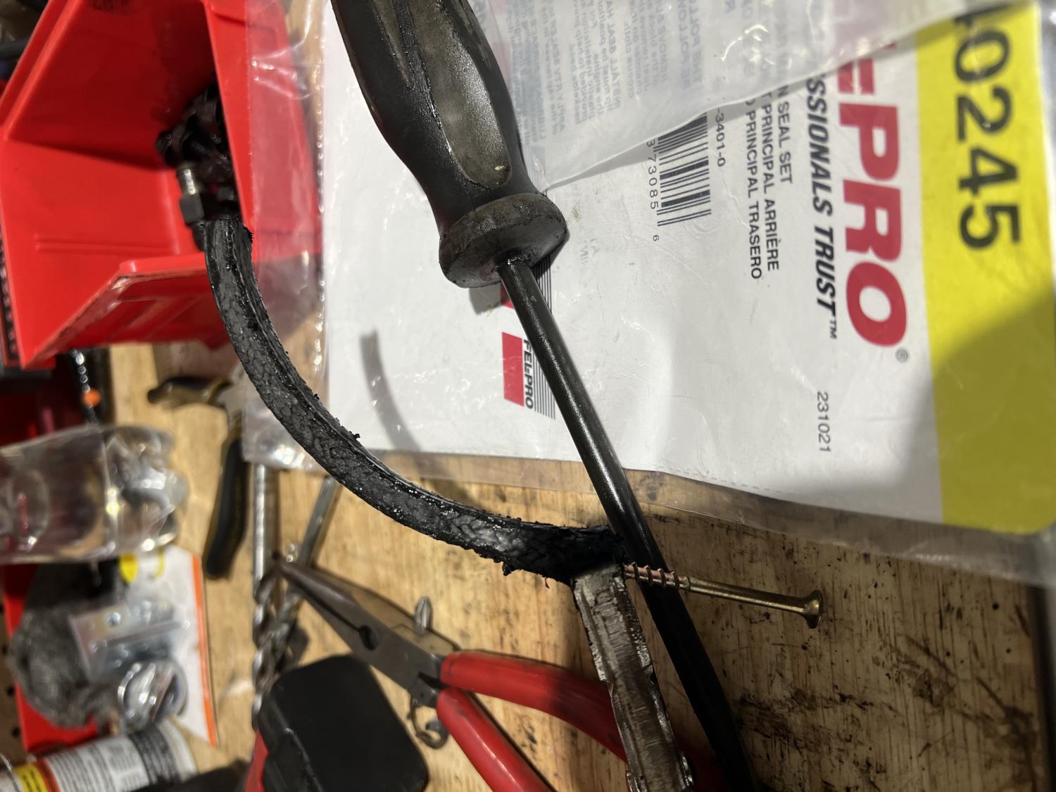

Thanks for the advice fellas. I have replaced the rope rear main seal already with a rubber two piece seal and used just a small amount of black rtv where the two ends meet. I used red anaerobic sealer between the block and the cap since they are machined surfaces. I am doing the front cover gasket and seal, valve cover and the intake gaskets as well. None of them ever appear to have been replaced and the engine is quite an oily mess but it runs very well. When I’m done it should look as good as it runs I hope!
