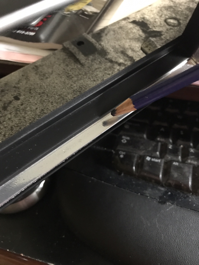

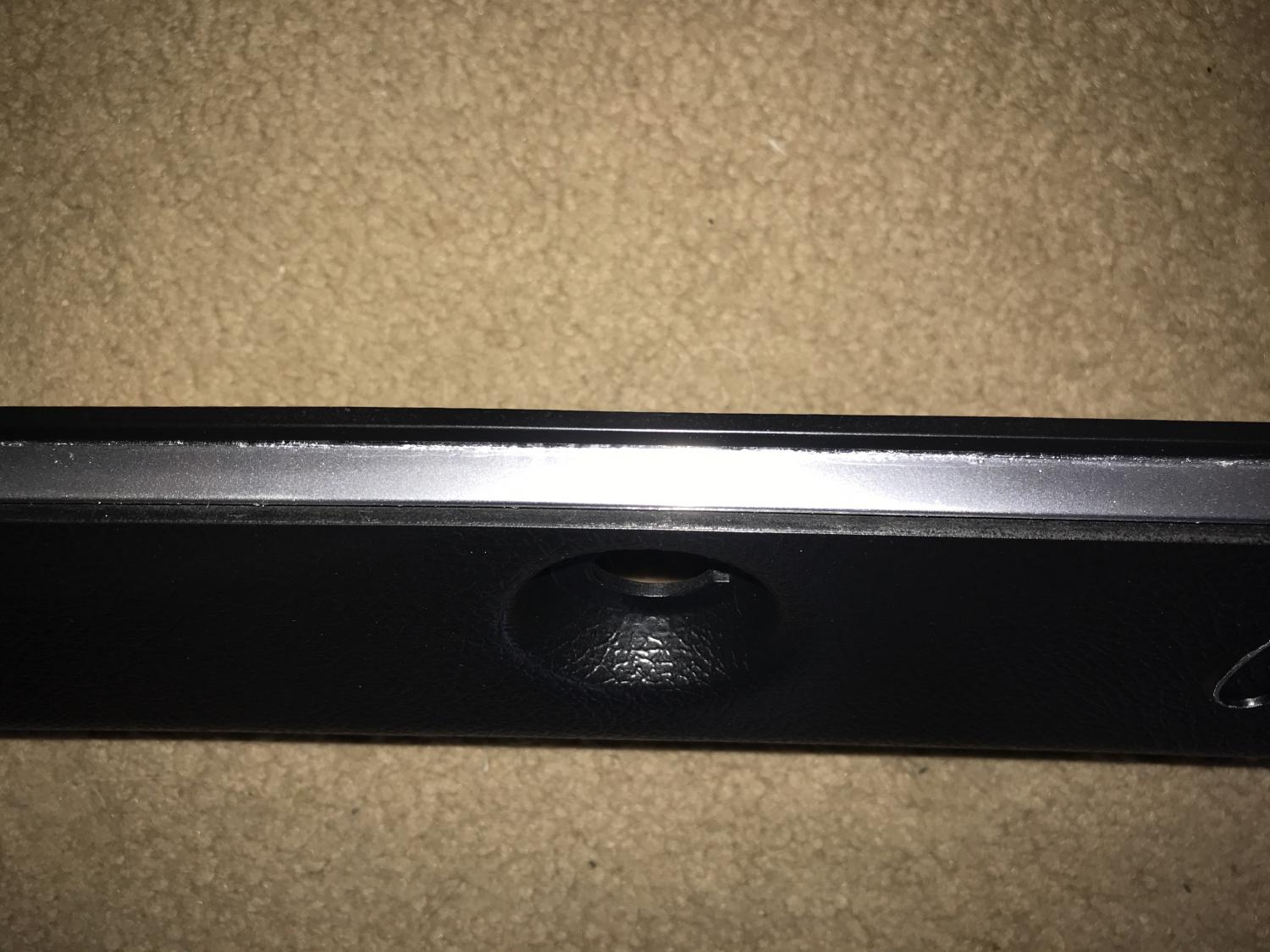

Anyone have a process for painting chromed plastic dash stuff?

I use the Molotow Liquid Chrome 2mm Paint Pen to highlight the horn shrouds and dash housings, you can buy it at hobby lobby, amazon etc, you can also spray this with a small air brush. I have a friend who also builds models & paints the bumpers chrome.

I see from your first post that you are looking at paint. I used the Molotow stuff on my dash trim, but it isn't supposed to have a highly reflective "chrome" finish anyway, but more of a glossy matte, so it worked well for me. I did mine with an airbrush and then followed with a clear lacquer for protection. It turned out well for me, but again, I didn't want a high reflective finish like most dashes have.
