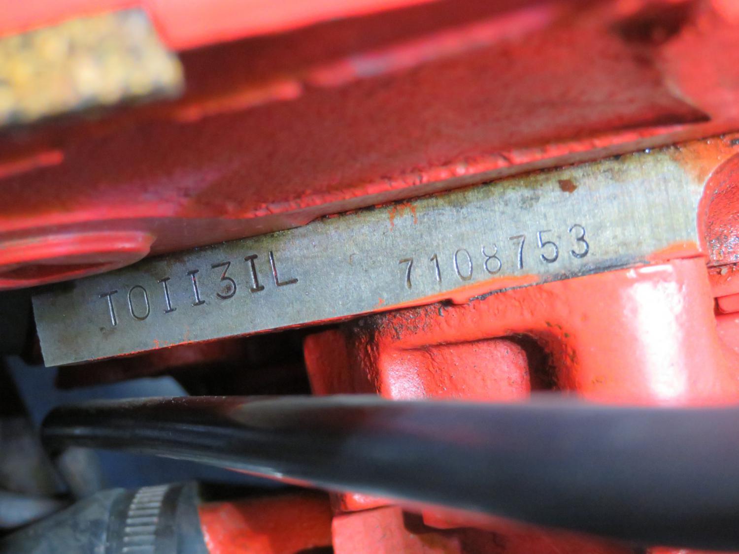

Does anyone here who collects pics of real factory Tonawanda big block stamps have any examples in the March - June 1967 timeframe with a round-topped 3 in the Tonawanda assembly stamp? All my examples (hundreds) have the flat-topped 3.
Looking at a car that everything looks pretty legit on, except a round-topped 3. I have one stamp the very same day with a flat topped 3, but it is a different suffix.
Pretty confident it has to be a restamp, but thought I would ask here before putting the final nail in the lid.
Feel free to PM me if you prefer versus posting any pics on the public forum.
Thanks!

Jeff,
I have a January stamp if that is of any help (with a 3). I also have a May stamp (but no 3)
Tim

Originally Posted by napa68 View Post
Jeff,
Tim
Thanks. Flat topped 3 like all my examples.

Old 06-12-2024, 05:24 PM
TimG TimG is offline
Location: Austin, TX
Posts: 4,465
Thanked 2,427 Times in 949 Posts
They had a number of different fonts to choose from. I’ve seen unusual numbers show up as one off examples. It would be best to find a an assembly with same date and build code that is legitimate for comparison. The next best is to find one that is close to the same date with the same application.
Old 06-12-2024, 05:55 PM
67since67's Avatar
Join Date: Mar 2016
Location: Waterloo Iowa
Posts: 2,093
Thanks: 3,430
Thanked 5,202 Times in 1,203 Posts
Three March and one June here, all flat top 3.
Old 06-13-2024, 02:54 PM
fsc66 fsc66 is online now
Join Date: Nov 2013
Location: Long Island, NY
Posts: 919
Thanks: 185
Thanked 523 Times in 226 Posts
Default Engine pad
Loads of pics here on now of Dale’s pages but all 3’s from Tonawanda are flat tops:
https://chevelleworld.macswebs.com/6...ix_samples.htm
Paul
[email protected]

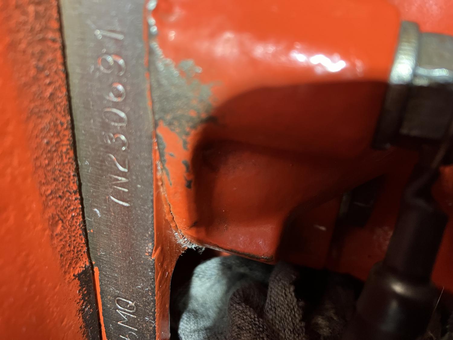

Default 230691
Jeff, I just now removed the paint from my block to get a more clear picture of my stamps. The 3 in my vin stamp is a round top 3. As you can see the block is the last week of May stamp. Cars TT is 06A.
Richard
1967 Camaro SS 396/375 4K
