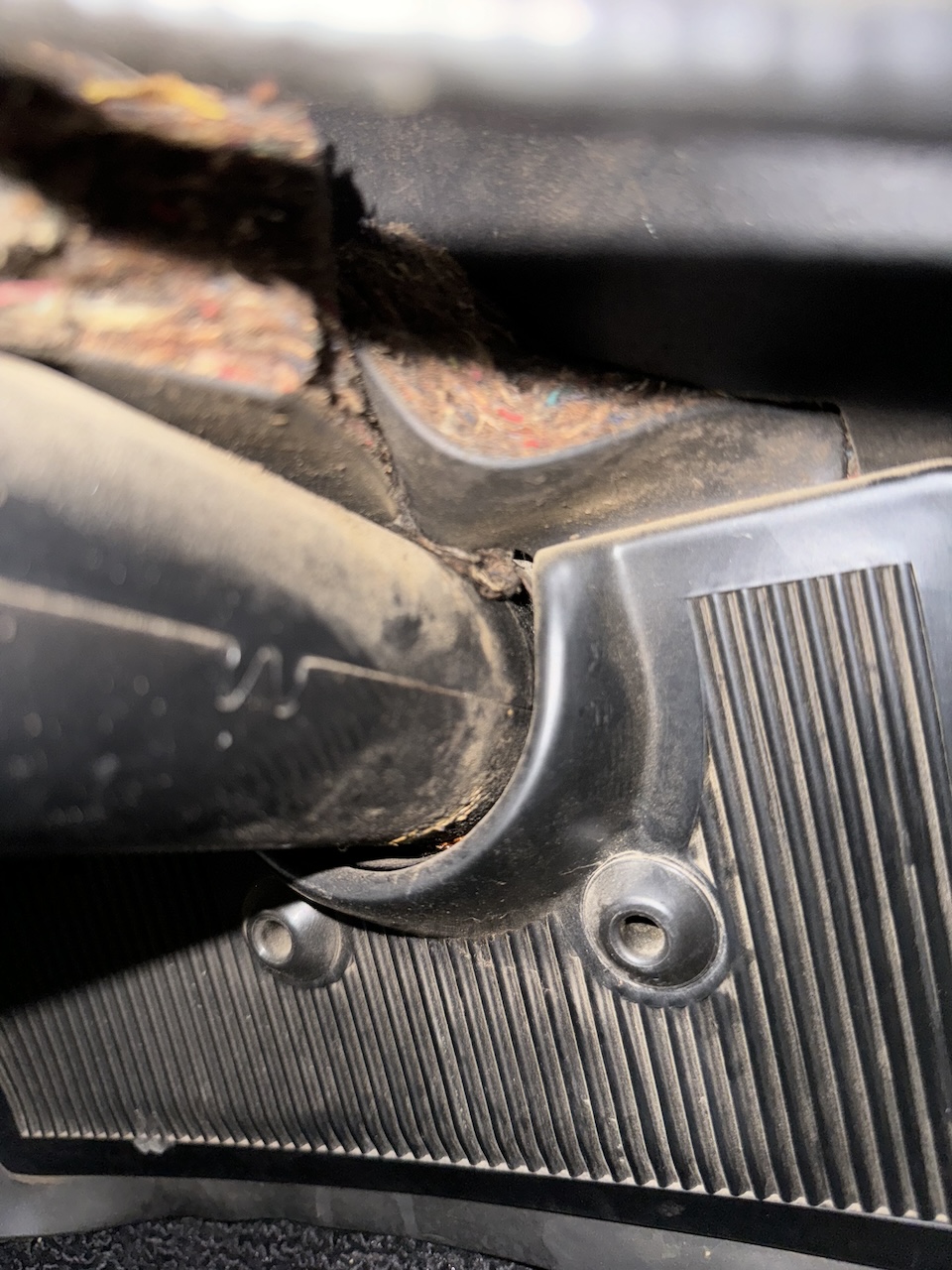

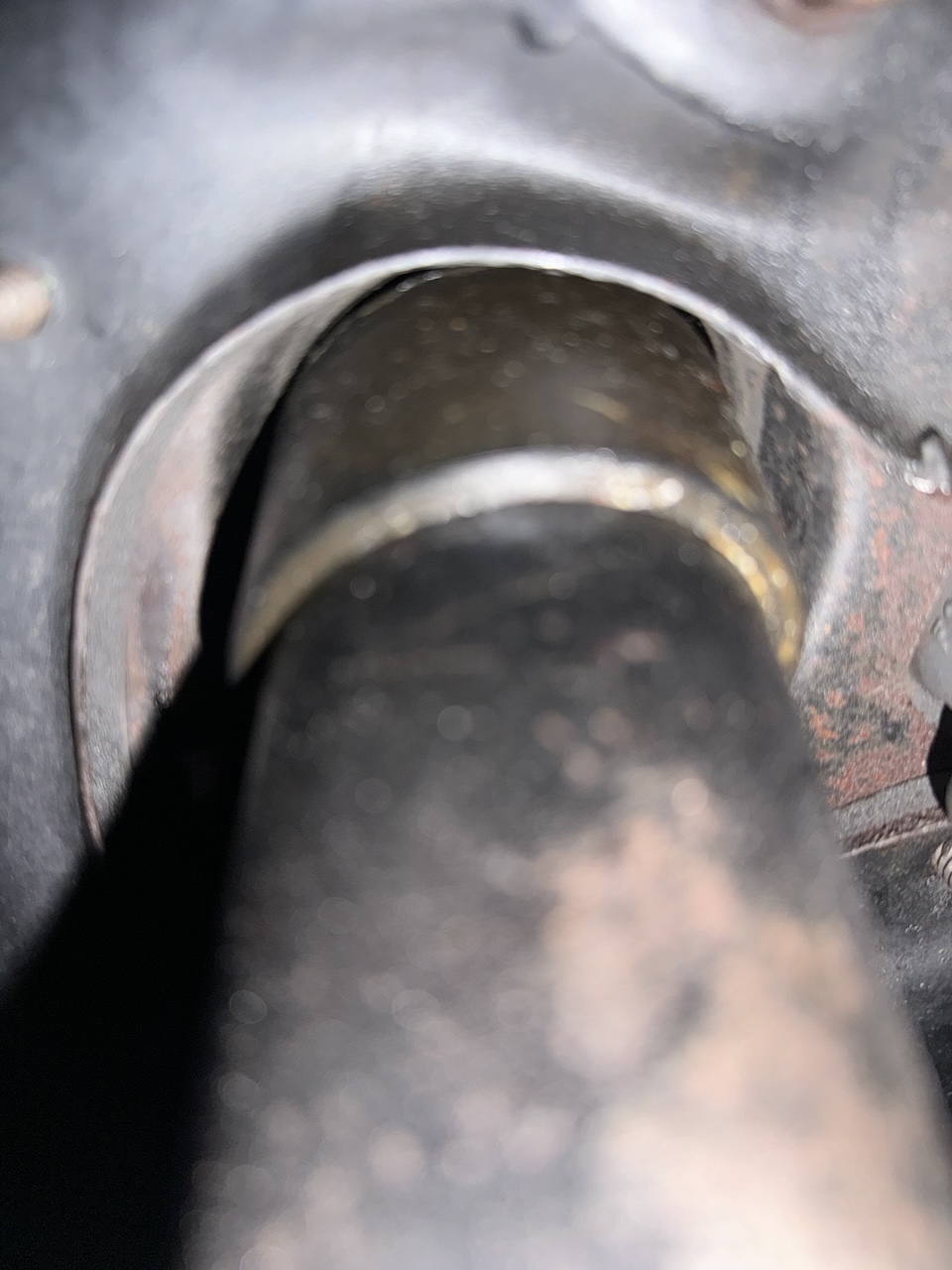

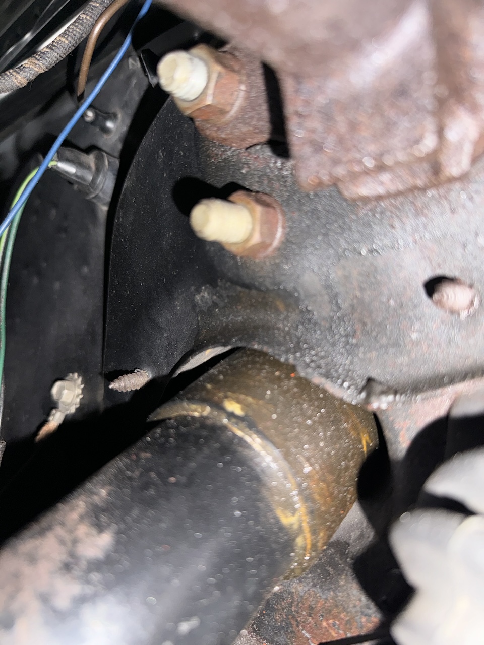

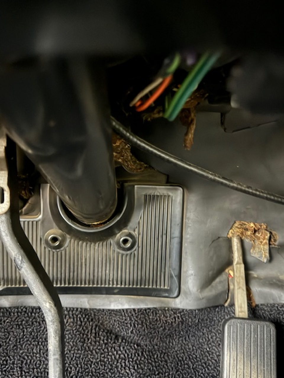

Pix from my '66 Mitch. Not seeing that bracket though?? On '67 it's an integral part of the firewall hole cover plate.
Didn't find the spare column, apparently that's passed on to a new home.
Maybe '65 would be similar to '66??
Good Luck!

Thanks Bill, I don't recall ever seeing the bracket on the outside of the firewall. I have a couple other mounting plates that clamp the tube on the inside, but the AIM shows them for different columns than a floor shift one.
Did you look at the inside to see if you had a large rubber cover over the mount ?

Pardon my 58 year dust accumulation...

Thanks Bill, it's just as a I suspected, only the carpet guard. I've never come across a "grommet" in that area.
Once I get the bracket from Steve and see if it fits and would help secure the column, I'll be ready to install it back in the car.
