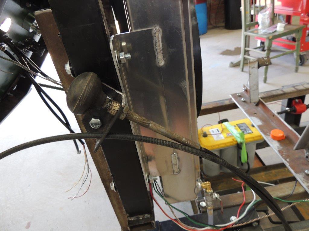

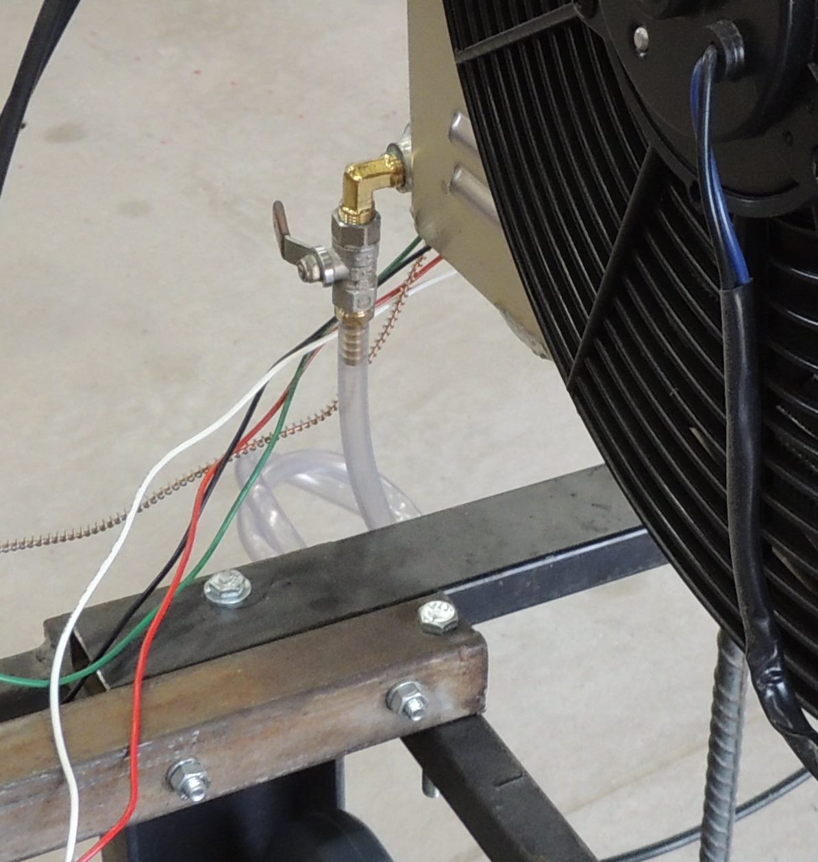

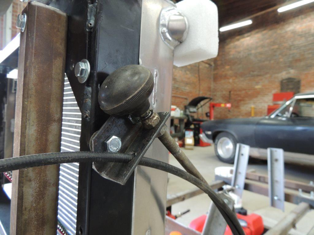

I know at least one member has one of these. I was going to build my own, as I have all the steel I need. Bought a bunch a few years ago at a surplus auction for about 5 cents on the dollar. Building one for just Chevy motors would be pretty easy; but I need to accommodate an SBC, a Supercharged Studebaker V8 and a Ferrari V12. That will be a bit more challenging.
But, the older I get the less time I have, and frankly, things I could knock out in a weekend when I was SuperDave's age, take longer now. So, I was considering purchasing one.
Looks like they may be out of business. Anyone heard anything?
I did request a quote from a third party vendor, but haven't heard anything yet.
Attachments - The Supercar Registry Throttle.3.jpg Throttle.2.jpg Throttle.1.jpg RadiatorDrain.2.jpg

While on the subject, I cannot find a universal radiator that has dual inlets and outlets.
Any kind of search for such a beast just yields results for a "dual pass" radiator.
Somebody made one, as that is what came with the EasyRun.
Where do I get one?

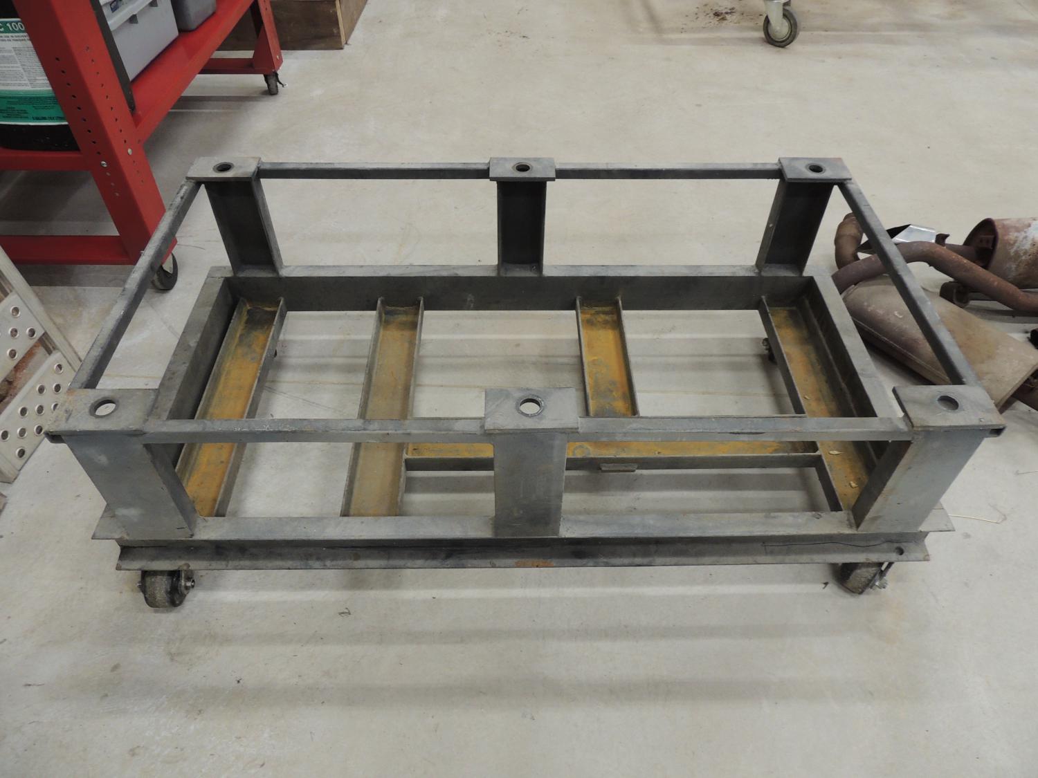

Resurrecting this thread. Looks like EasyRun is done, or at least MIA for now.
Decided to build my own. I have a good start. This is an extra body cart I got with a lot of parts I bought last year.
Really heavy "C" channel construction. The six pads on top are all 3/8 steel.
Figured I would build some dedicated stands for a Chevy. Then, when I get to the Studebaker supercharged engine, build some dedicated stands for that motor. Then, when I am ready to run the Ferrari V12.... well, you get the idea.
Anyone have some decent "plans" for an engine run test stand. I will adapt whatever is out there to this cart. It is 52 inches long and 26 inches wide.

Plan to put some larger casters on it with locking feature.
