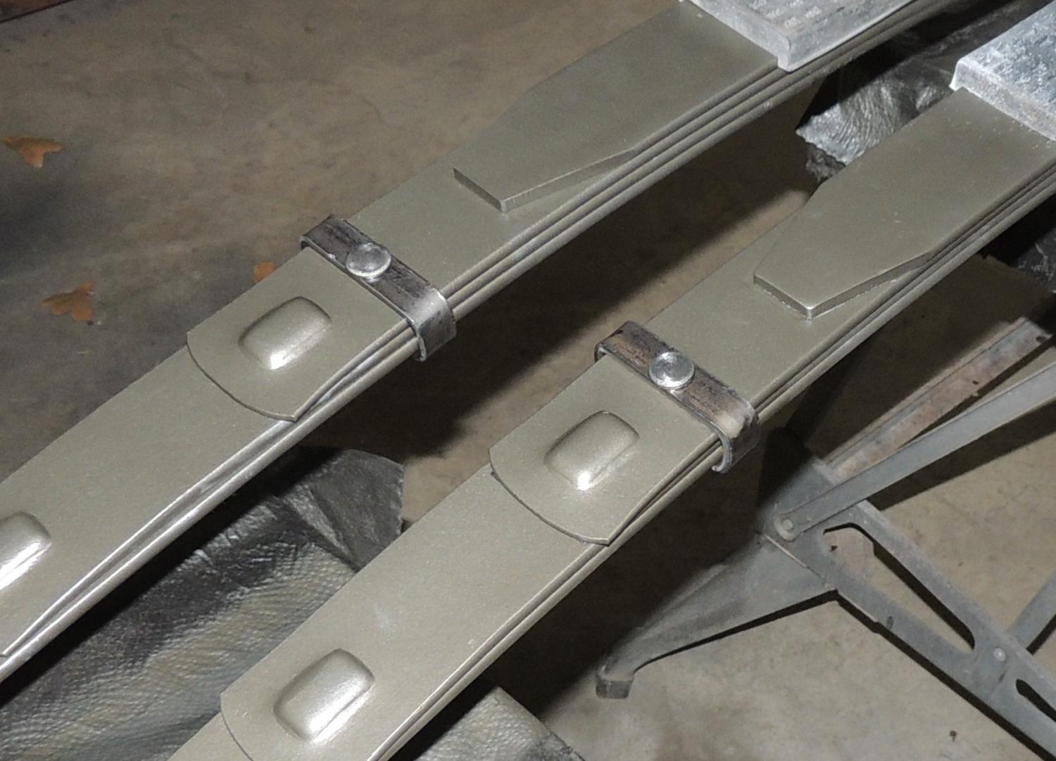

Where can I get the plastic insulators and clamps to rebuild my 69 camaro 4 leaf springs. The kits they sell are crap.

The insulators rarely wear out. You should be able to find some used ones.
I made my own clamps. You are correct, The repops suck.

Pic.
