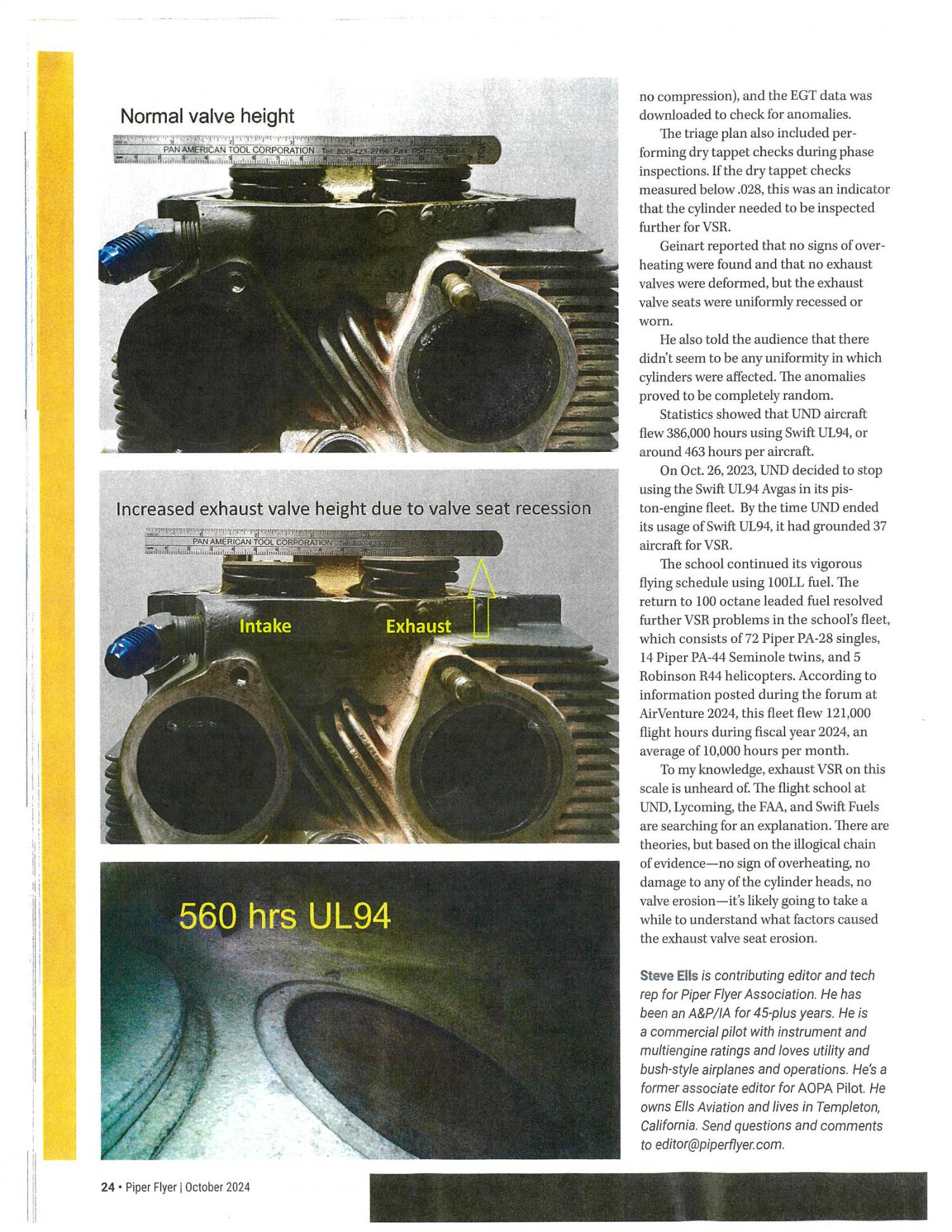

Just a follow up on the UL94 discussion...just read this article today in the Oct 2024 issue of Piper Flyer magazine. Take into consideration trying to directly compare air-cooled aircraft engines to water-cooled automotive engines is in large part apples-to-oranges, but thought it interesting...
