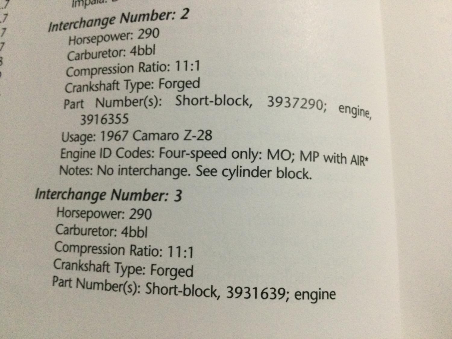

More

I agree with the interchange info. That doesn't mean the 010 block was put into usage any earlier than April 1969. I have one in my 68 El Camino with all the 1968 bracketry.

010 blocks started in the end of March.
That interchange info is not helpful to the topic at hand nor is it accurate. As an example, I've seen 5 different blocks used in 69 Z28's - it shows 2. CBTN is more informative.
