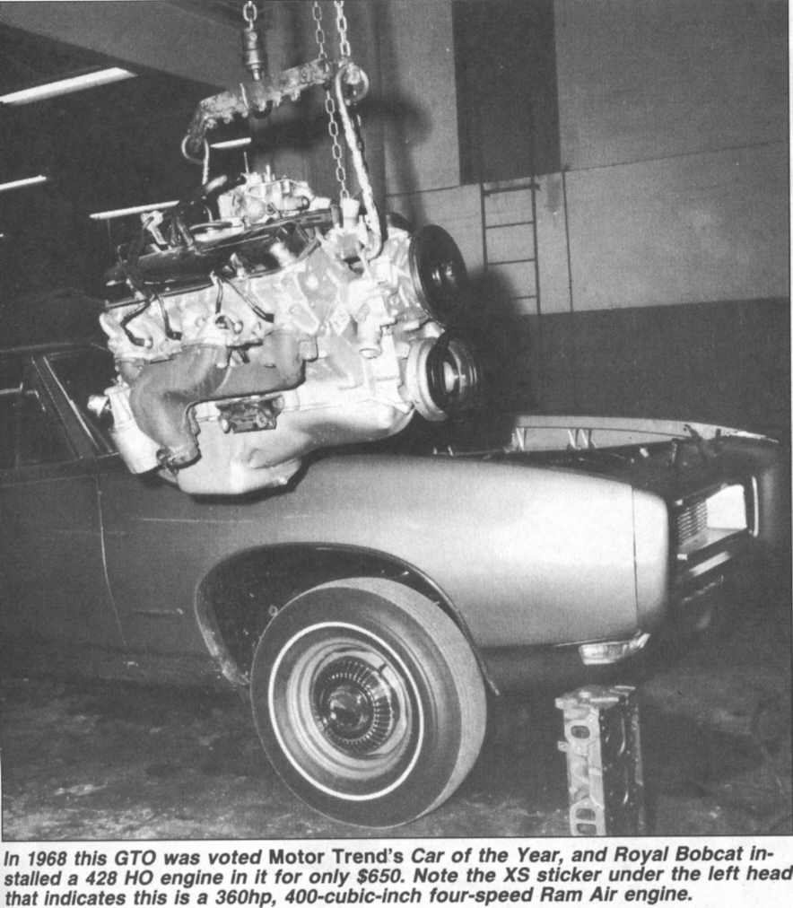

I have seen a 1966 GTO at some car shows and it has a 421 cu. inch engine with the tri power set up on it and the guy claims that it is original. Did they ever put 421's in a GTO and did they ever put the tri power on a 421? [img]/ubbthreads/images/graemlins/dunno.gif[/img]

You could get Ace Wilsons Pontiac to install a 421 in your GTO. Possibly thats what happened with this GTO.
To answer your other question...Yes 421s could come with a tri-power.

I'm pretty sure Royal Pontiac was doing 421 conversions on GTO's by then... but to the best of my (limited) knowledge there were no factory 66' 421 GTO's made
