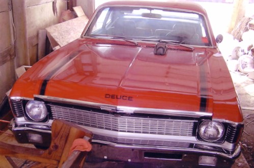

Mike you mean this garage?
If you look close enough on the left side of the photo you can see the stripes of Joey's green Deuce in front of mine!

Photo credit goes to Camarojoe!
