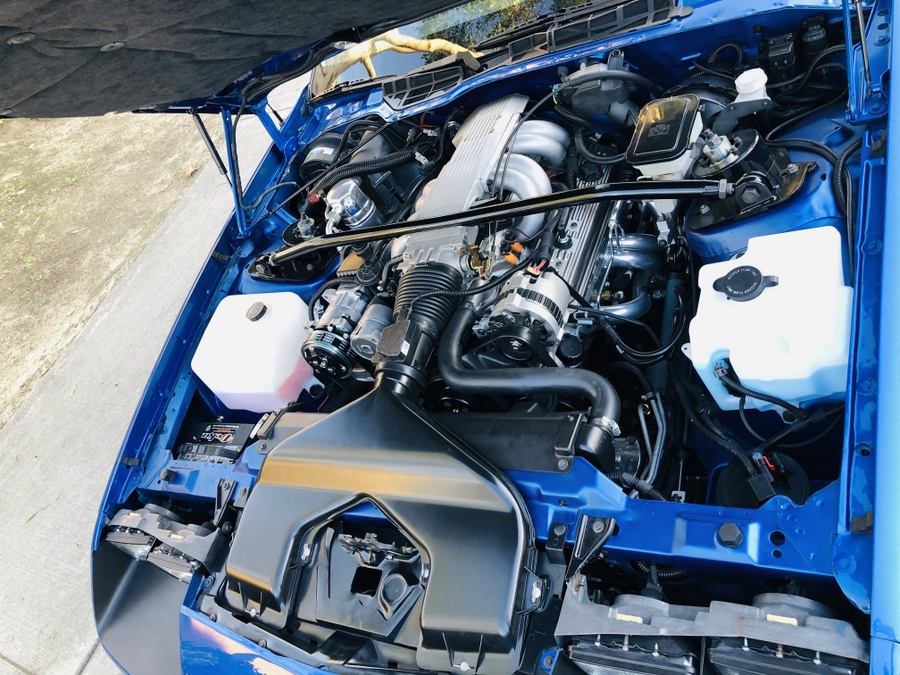

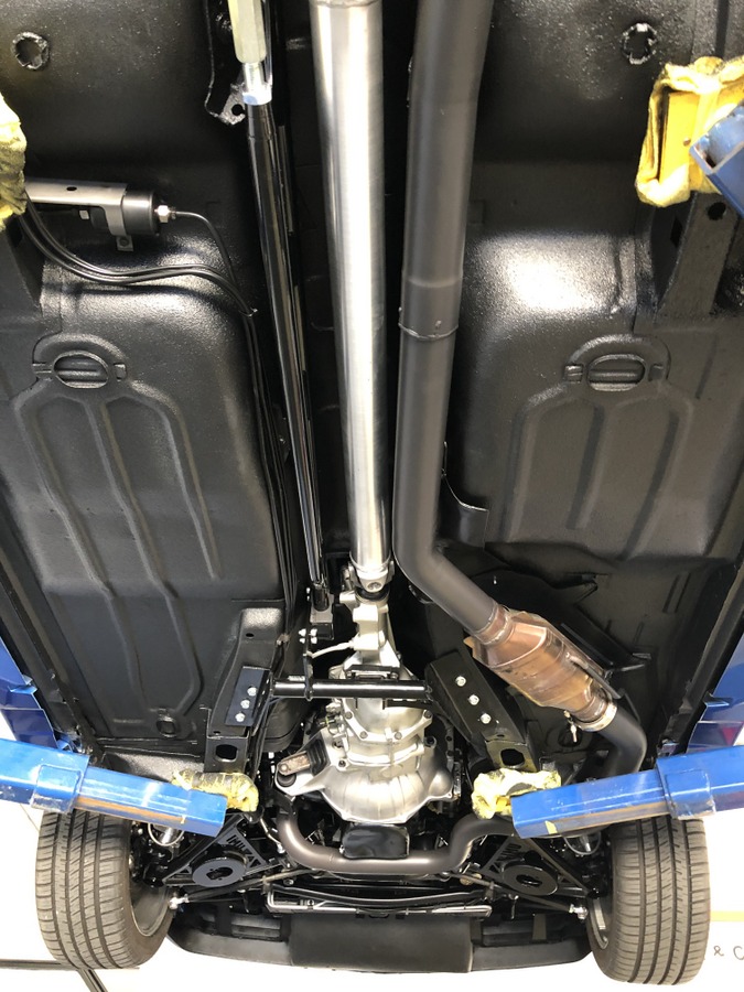

Ok being I'm in a weird mood and looking at 1950s F100 Ford trucks. I figured I would show off my recent Disco Build. Blue 89 IROC 305, 5 Speed T top car. All Numbers matching , but with modern updates. She passed our strict California Smog laws with flying colors, and its a blast to drive.

Looks like one of your typical well engineered projects. Can I ask the specifics of the modernization efforts? Is that still a tiny-bore 305 making those numbers? Thanks in advance...
Old 10-31-2019, 10:17 PM
KenMaisano's Avatar
KenMaisano KenMaisano is offline
Join Date: Jun 2013
Location: So .Cal.
Posts: 446
Thanked 165 Times in 81 Posts
Stock Bore 3.766 but stroked it to 3.750 Now 334CUIN. NOTE, How I decked the block without removing the VIN Numbers
9.5to1 Compression, Bored with Torque plate and Plateau finish hone
1620 Grams Internal Balanced 3.750 Stroke
Airflow through complete induction system @.500Lift 210CFM @28" Air Speed FT/SEC 300
Crane 214-220 112 482 496 lift/after 1.6 rockers in at 108 #2032
Trick flow 170 Heads
Edelbrock fully ported lower with EGR
SLP Runners
Ported GM Upper
52MM Throttle body
22LB Bosh Injectors
Hooker shorty Headers
