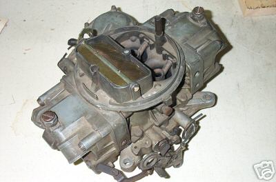

hey guy's i just got my hands on a 3130 holley carb.
its a hp 427 chevy engine carb...
don't see it listed in holleys web site
just wondering if this baby is very rare
thanks mark

65 Chevy big car.......
425 horsepower 396
Original carb came with the real small inlet, center pivot bowls
These bowls were used on 65 carbs only
Looks same as original 3124 Vette and (original) 3310 Z16 carb

IF it is a 65 or 66 date it should have the small inlets and would be a valuable carb. The photo shows the later bowls, hence it is a service replacement (like 99.9% out there) and has utilitarian value only. Same goes for the 3310.
