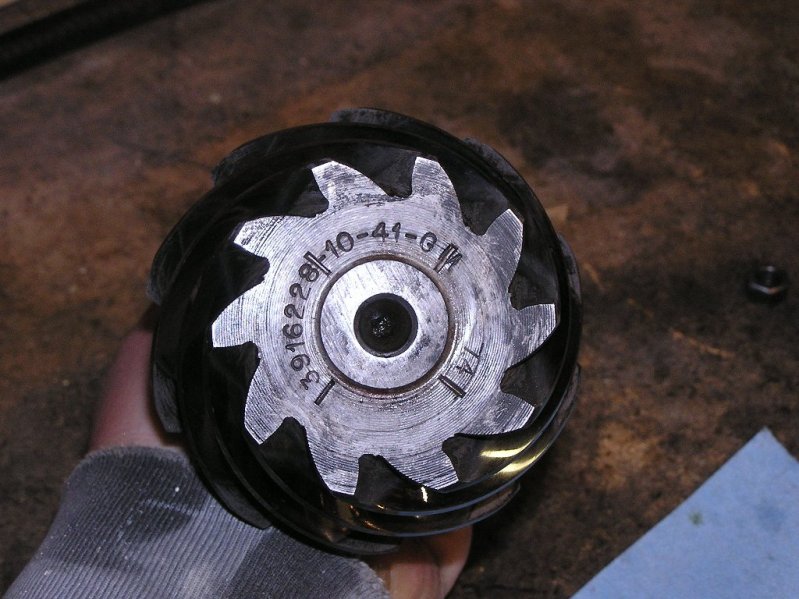

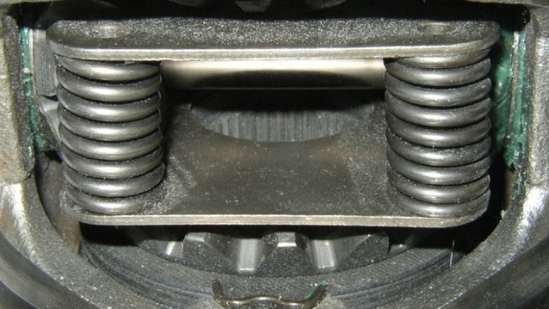

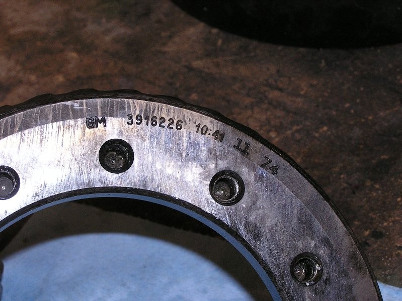

Ok.... so it looks like I have a set of these gears that came with a 174 posi unit I bought back in October. They have been sitting on the shelf ever since. How do I tell if the posi unit is a COPO unit without taking it apart?

Here are some photos of what I picked up.

I think the correct side gears have no 'flange' on the sides facing the clutch plates. Hard to tell from your picture.

That is a standard duty 4-series unit, based on the posted pictures.
Here is a #234 unit to compare.

How about the difference in the dates..5-69 and 1-70?..did the factory gears come in sets??..I have a standard 4 10 gear set in my COPO and both gears have the sama date..just curious and do not want to diminish the value of these gears..oh and by the way [img]<<GRAEMLIN_URL>>/Can-I-Have-It.gif[/img] [img]<<GRAEMLIN_URL>>/beers.gif[/img]
