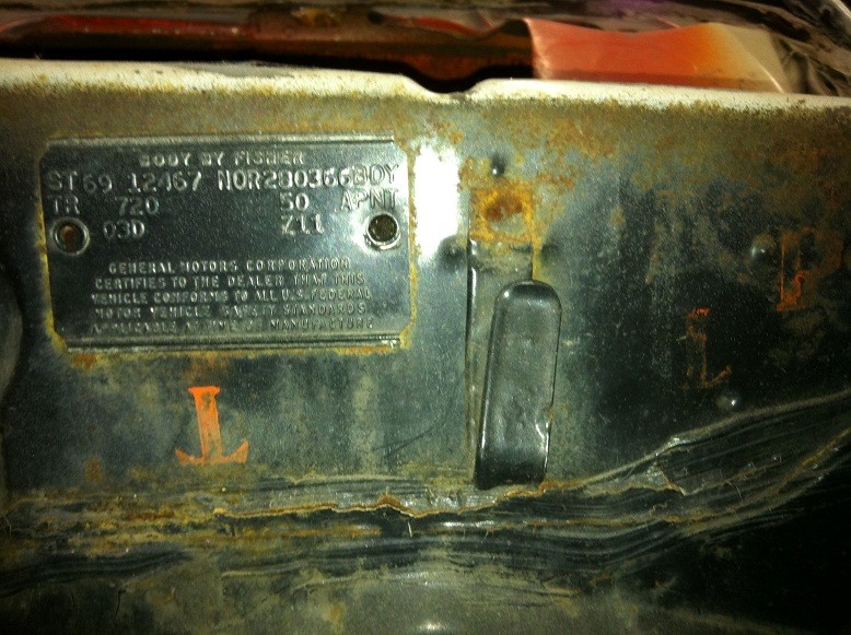

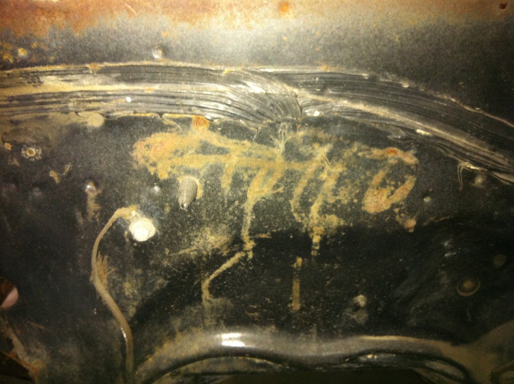

got back from brazil yesterday so went and took a few pics. looks like 740?? could be 720 for orange houndstooth?? dont think so...also looks like something else below..I am going to clean this week and see what shows up...will post pics...
this pic is in center of fire wall above tunnel...

can see two T,s and 1 P...there is another T and P on other side also...

other side of cowl..you can barely see the P and the T
