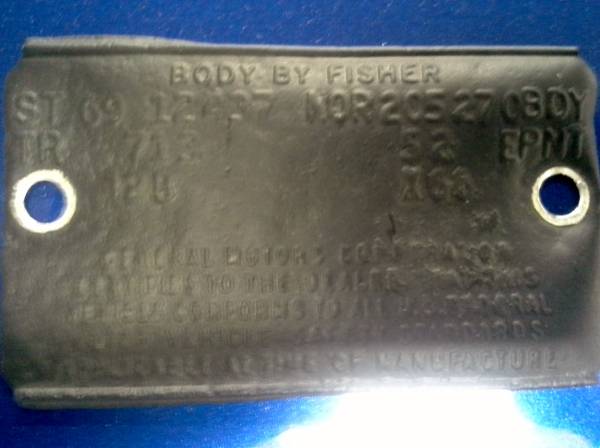

<span style="font-style: italic">&quot;Our Camaro was a mess so it was converted into a tube chassis race car with lots of fiberglass and a sheet metal firewall. If you are missing your Z28 trim tag or building a Z28 tribute car here is your chance to get the finishing touch. 785-207-0830</span>
X33 Z28 with Style Trim
12437 V8 Coupe
NOR245988 Norwood Plant
57PNT Fathom Green Paint (looks like code 67 Burgundy?) (E Parchment V/Top)
727 Ivory Standard Bucket Interior
12B Build Date 2nd Week of December
$350.00 obo

I believe the tag is a reproduction/fake

No doubt a fake.

X3 on the Z28 tag [img]<<GRAEMLIN_URL>>/smirk.gif[/img]

X33, I mean, Times 33 it is a not the real thing [img]<<GRAEMLIN_URL>>/youguysrock.gif[/img]

<span style="font-style: italic">We have smoothed the firewall for a pro-touring build so the trim tag has no use to us. If you are missing your Super Sport trim tag or building a SS396 tribute care here is the finishing touch. 785-207-0830</span>
X66 SS396
12437 V8 Coupe
NOR205270 Norwood Plant
52PNT Garnet Red Paint
712 Black Custom Bucket Interior
$300.00 obo

----Guy is certainly busy building all these race cars and selling all these tags......Bill S

<div class="ubbcode-block"><div class="ubbcode-header">Originally Posted By: Mr70</div><div class="ubbcode-body"><span style="font-style: italic">We have smoothed the firewall for a pro-touring build so the trim tag has no use to us. If you are missing your Super Sport trim tag or building a SS396 tribute care here is the finishing touch. 785-207-0830</span>
X66 SS396
12437 V8 Coupe
$300.00 obo</div></div>
This is an original tag.
